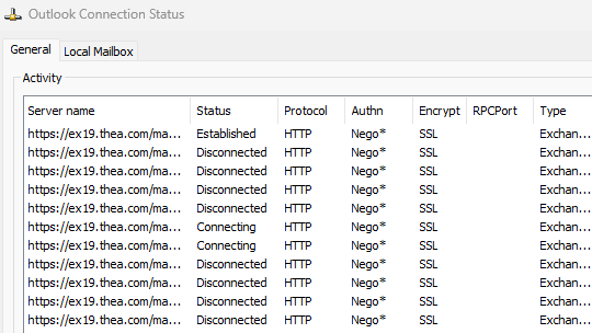

    3.When the authentication box pops up, please check the connect status to see what the situation is, as shown in the figure below. The method to view is press and hold the Ctrl key, right-click the Outlook icon in the notification area, and then click connect status.
