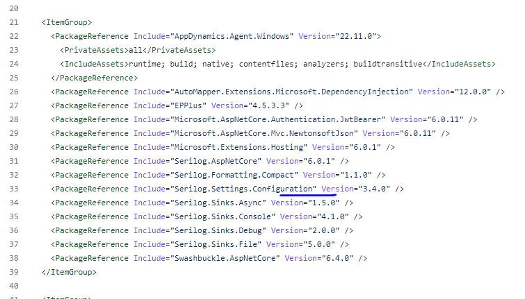

microsoft.extensions.dependency.model.dll - this dll is getting referred from serilog.settings.configuration reference in csproj file . I have tried adding separate package reference for that dll with 3.0.0 version but still its referring to 2.1.0 version after the build .
But what I observerd is the dll from following path is "Firm.API\bin\Release\net6.0" correctly referring to 3.0.19.** version but why output directory if referring to 2.1.0 version is the issue . I have installed dotnet core 2,3,6 SDKs on the new server . so currently the dotnet.exe is referring to 6.0 version .
