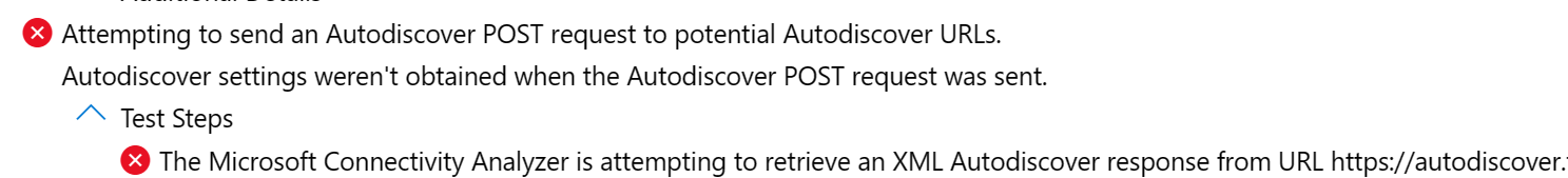

Microsoft Remote Connectivity Analyzer on Exchange server with failed accounts
The Microsoft Connectivity Analyzer failed to obtain an Autodiscover XML response.
Additional Details
An HTTP 401 Unauthorized response was received from the remote Unknown server. This is usually the result of an incorrect username or password. If you are attempting to log onto an Office 365 service, ensure you are using your full User Principal Name (UPN).

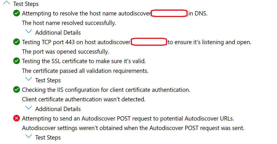

Microsoft Remote Connectivity Analyzer on Exchange server with success accountsImage
