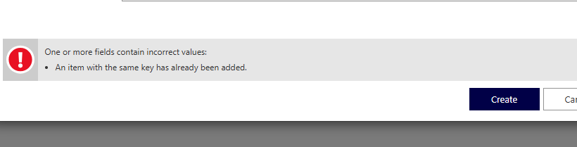

System.ArgumentException: An item with the same key has already been added.

In the above error, you can see that sometimes we are getting null instead of object and when I tried with the trace then found the following error:
    "ClassName": "System.ArgumentException",
    "Message": "An item with the same key has already been added.",
    "Data": {},
    "InnerException": null,
    "HelpURL": null,
    "StackTraceString": "   at System.ThrowHelper.ThrowArgumentException(ExceptionResource resource)\r\n   at System.Collections.Generic.Dictionary`2.Insert(TKey key, TValue value, Boolean add)\r\n   at Microsoft.WindowsAzure.ApiManagement.Proxy.Gateway.Policies.Transform.PipelineMessageExtensions.SetBodyPolicyMessageProcess(IPipelineMessage message, IPipelineContext context, String processedContent, CancellationToken cancellation)\r\n   at Microsoft.WindowsAzure.ApiManagement.Proxy.Gateway.Policies.Transform.SetBodyValueHandler.ProcessAsync(IPipelineContext context, CancellationToken cancellation)\r\n   at Microsoft.WindowsAzure.ApiManagement.Proxy.Gateway.Policies.PipelineWalker.
