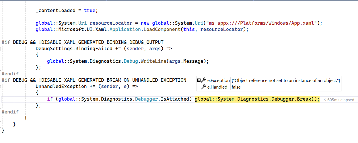

2024-02-06T09:16:19.1433333+00:00 The exception:
Dani_S • 4,501 Reputation points
2024-02-06T09:16:51.8133333+00:00 The exception:

Why FirstChanceException is ht in relase mode but UnhandledException not ?
2024-03-24T11:01:45.73+00:00 can you please check with sample code in the end of in this link:
https://github.com/dotnet/maui/issues/21007
why UnhandledException not work.
