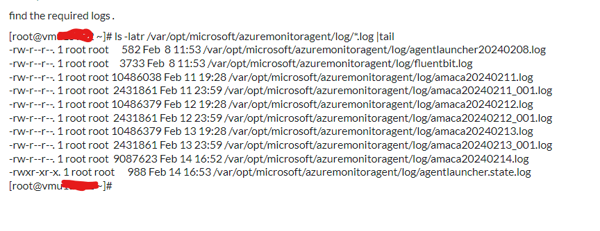

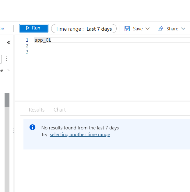

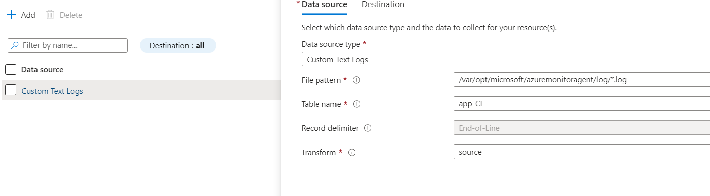

I have configured Custom logs with Azure arc linux server via dcr association but the logs are not coming in portal. I checked the path in linux arc machine, the logs are visible there but not coming to the portal. Can you please tell what is the issue?
Also the heartbeat of agent is coming.log

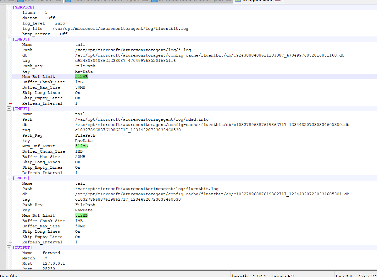

    I am not sure what you meant by txt path - but I checked and the td-agent.conf file in my "working" scenario is identical to what you have - with the entries under the first "[INPUT]" block. You seem to have created multiple DCRs to track 3 different file paths?
    Regarding configchunks, you are right - there should be a json file with details of log file path which is being attempted to be collected and additional details related to monitoring endpoints etc. It seems that the local config is not in sync with the DCR in portal.

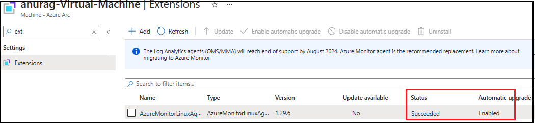

    1. Check the "Extension" resource menu of this Arc server in Azure Portal. There should be an entry like below (to ensure that the extension is installed and healthy) User's image

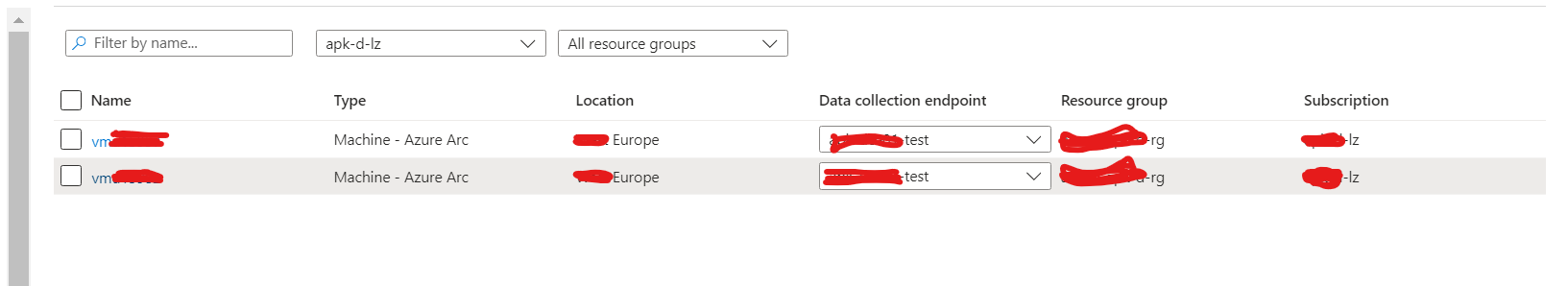

    Ensure that you have created Data collection rules with the correct "data collection endpoints". Data Collection Endpoints facilitate the distribution of configuration from Azure to machine and also the log collection from machine to Azure. If they are not properly set, the issues may arise as we see in this case. For more details see point 3 & 4 in the following link - Create a data collection rule to collect data from a text or JSON file. Note, there are 2 locations where Data Collection Endpoints is specified when creating DCR. For details, see How to set up data collection endpoints based on your deployment
