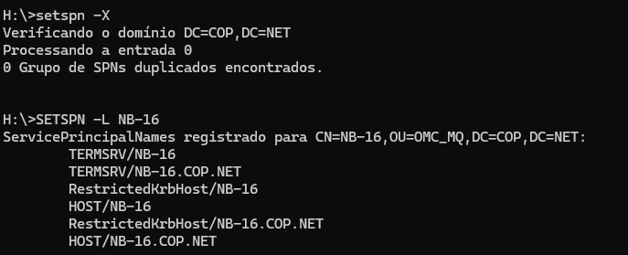

  1. Marcos Santos 20 Reputation points
    2024-03-20T11:35:53.28+00:00
    I did the procedure as requested as shown below I did it both on the server and on the NB-16 machine
