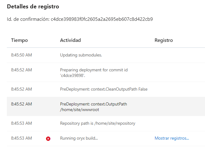

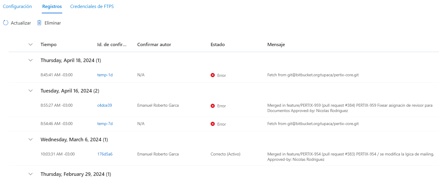

Hi! Since a pair weeks, i'm getting an error when trying to deploy a web app from the deploy center:

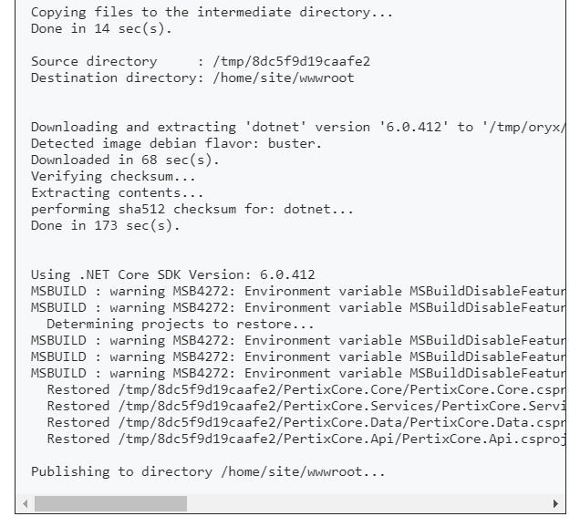

When i go into the deploy c4dce39, which is in an error state, the "Running oryx build..." step is the last one on the list, but in its registries there aren't any errors at all. It looks like the process was killed.
