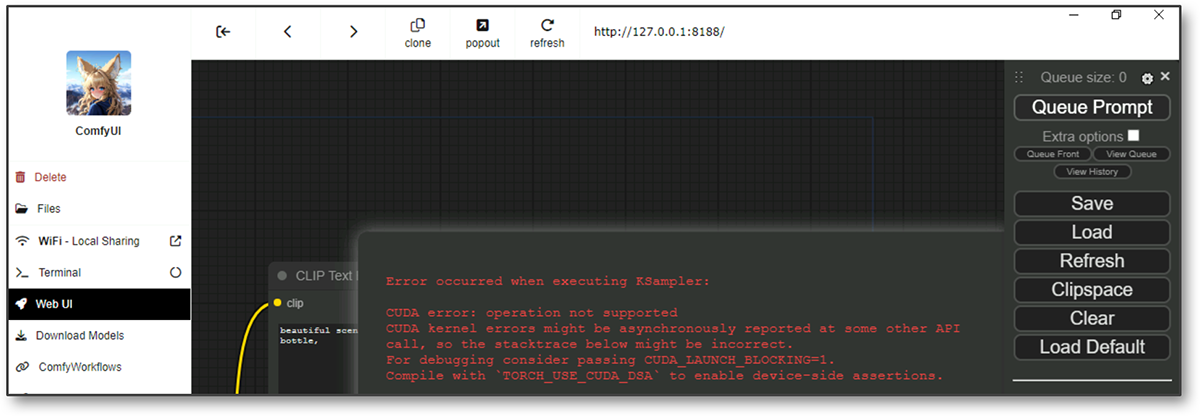

Hello, I recently created a virtual machine with the Standard_NV36adms_A10_v5 product and tried to use Stable Diffusion.
However, entering the nvidia-smi command causes a "No devices we found error."
And while using the optimized image provided by Azure, the "NVIDIA-SMI has failed because it could't communicate with the NVIDIA driver. Make sure that the late NVIDIA driver is installed and running."
nvidia-smi
NVIDIA-SMI has failed because it couldn't communicate with the NVIDIA driver. Make sure that the latest NVIDIA driver is installed and running.

azureuser@vm-rg-ailab-p-us-a10v5-vram24-003:~$ nvidia-smi
You have also tried reinstalling the CUDA Driver, but the virtual machine does not restart.

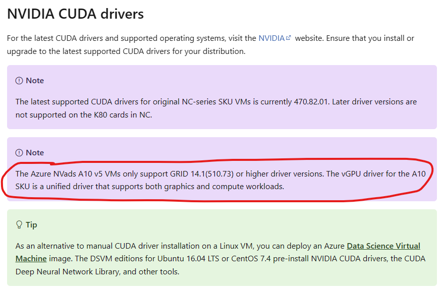

While trying to determine the cause, the Docs document confirmed that the NVadsA10_v5 series only supports Grid Drivers.
By any chance, is Stable Diffusion Cuda impossible to use because NVadsA10_v5 series only supports Grid Driver?
If so, is it possible to use Stable Diffusion Cuda for NCadsA10_v4 series that is not in the document?

    What drivers can I use on NVads A10 v5 VMs? What about A10 VMs?
    I reached out to the virtual machine team and you are correct:
    • In the case of the NVads A10 v5 VMs, only GRID 14.1(510.73) or higher driver versions are supported.

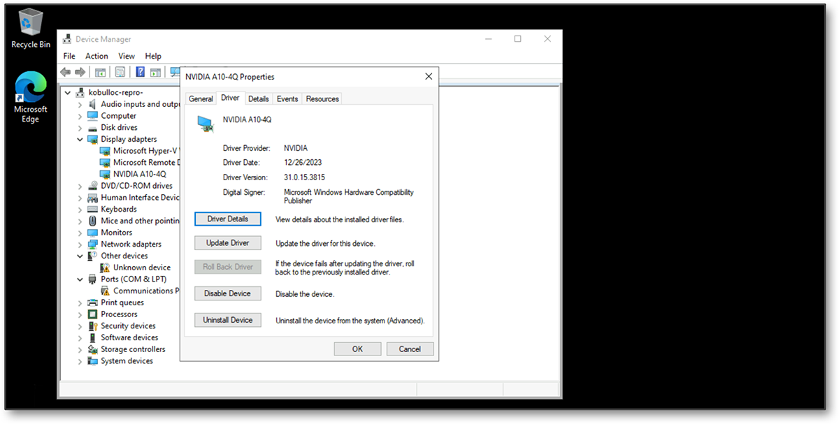

    • In the case of the A10 SKU, Azure uses a GPU-P implementation which uses a unified driver that supports both CUDA and GRID functionalities. We publish the supported driver; after that during CUDA package installation you should skip the driver option.
    This means that you would not use the NVads A10 v5 VM for CUDA dependent workloads. In theory, the A10 unified driver for other VMs should support CUDA workloads.
    Edit: After testing, I have not yet been able to get Stable Diffusion to work on this specific SKU. I would recommend another GPU SKU for Stable Diffusion workflows.
