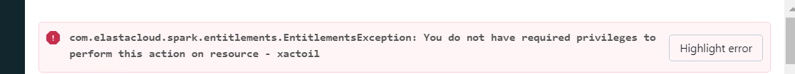

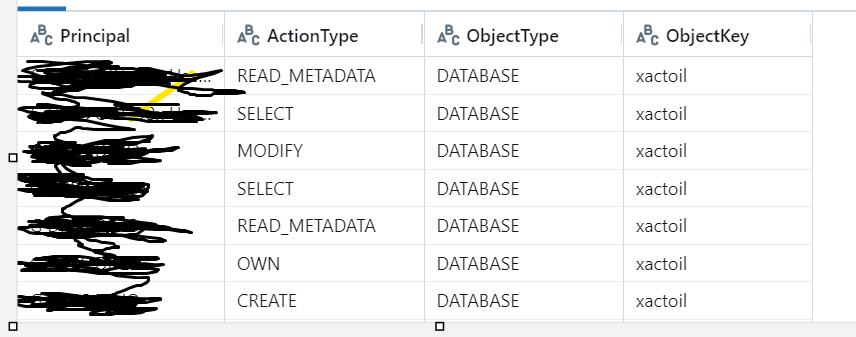

When running the jobs in databrick user is getting the insufficient privilege error, but user do have all the privileges like select, read_metadata, modify, create and owner as well on the respective database.

    It seems like you are facing an issue with insufficient privileges error while running jobs in Azure Databricks. Based on the error message, it looks like you do not have the required privileges to perform the action on the resource "xactoil".

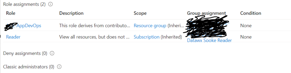

    • Verify that you have the correct permissions on the resource "xactoil". You can check the permissions by going to the Azure portal and navigating to the resource. Then, click on the "Access control (IAM)" tab and verify that you have the required permissions.
    • If you do not have the required permissions, you can ask the owner or an administrator of the resource to grant you the required permissions.
    • If the issue persists, you can try running the job with a different user account that has the required permissions.
