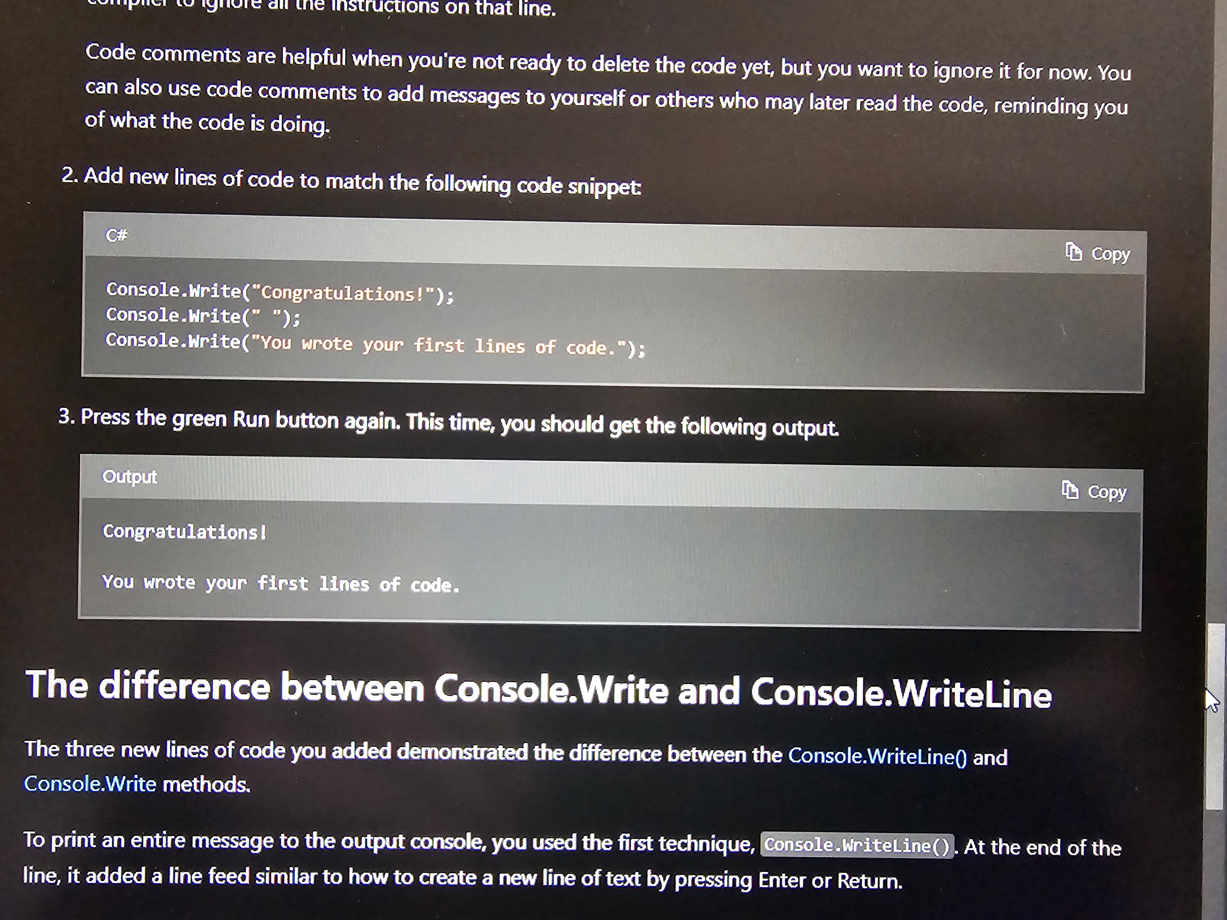

I entered the code, as instructed: Console.Write("Congratulations!");
Console.Write(" ");
Console.Write("You wrote your first lines of code.");
The output was all on the same line: "Congratulations! You wrote your first lines of code.", however, according to the course, it should not have been.
In order to get it on separate lines I had to use Console.WriteLine every time.
I just want to make sure I understand this properly before moving on.
Please see attached picture.20240425_132636

    The output you got is correct. The Output shown in the exercise is wrong. It should have it all on one line.
    See this excerpt from the exercise text:
    To print to the output console, but without adding a line feed at the end, you used the second technique, Console.Write(). So, the next call to Console.Write() prints another message to the same line.

    After discussing with the content author, they have confirmed that the Learn paths will undergo revision and updates in the forthcoming major update, which is expected soon.
