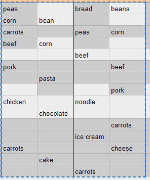

Hello, I'm trying to create a list of Names and the Number of times they appear from a box of information similar to the picture.
Current data range is B2:AT21
Below the data range I was in putting the Formula
How would I write the formula to automatically pull the name of the items from the box of information without getting blanks or duplicates?** (that way it will auto populate a list)
I inputted in the column next to it "=Countif(B2:AT21;A24)" and reference the cell next to the left as the unique id to get the count.
Thanks in advance
Box of information:
Main List w/quantity

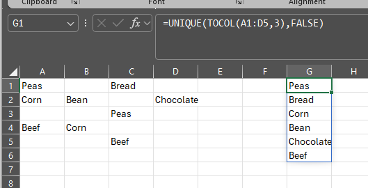

  2. Jiajing Hua 18,065 Reputation points Moderator
    2024-04-29T06:32:10.6466667+00:00
    Hi @JayDee
    I suggest you try to use Tocol and Unique functions.
