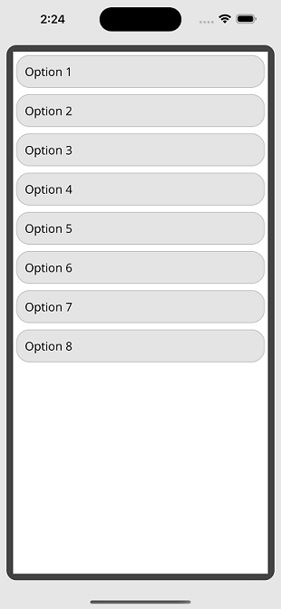

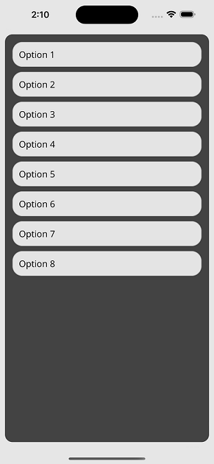

Expected Output of light and dark mode is belowScreenshot_20240429_185552

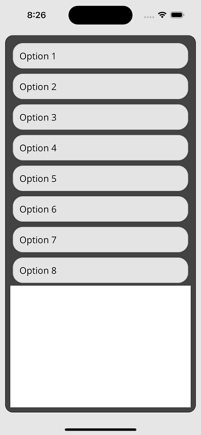

Current output in iOS:
Simulator Screenshot - iPhone 14 Pro - 2024-04-29 at 08.37.49

When changing mode, I am updating the color of homelistview and home_layout but it is not updating completely. When changing from light to dark, white color is showing for the Listview instead of darkcolor and when changing from dark to light a darkcolor is showing for the listview instead of white color. The issue is only on ios platform and working fine in Android platform.

  1. Wenyan Zhang (Shanghai Wicresoft Co,.Ltd.) 36,436 Reputation points Microsoft External Staff
    2024-05-09T08:31:32.6566667+00:00
    Hello,
    You have a Grid that wraps the frame, but you didn't set BackgroundColor for it. Please bind a BGColor and set the BackgroundColor of Frame to "#e4e4e4".
    <ListView.ItemTemplate>
                        <DataTemplate>
                            <ViewCell>
                                <ViewCell.View>
                                    <Grid BackgroundColor="{Binding BGColor}">
                                        <Frame
                                            HasShadow="False"
                                            Padding="8"
                                            CornerRadius="{OnIdiom Phone=20, Tablet=30}"
                                            BorderColor="#bdbdbd"
                                            Margin="5"
                                            BackgroundColor="#e4e4e4">
                                           <StackLayout
                                                VerticalOptions="FillAndExpand"
                                                Margin="5,0,5,0"
                                                Orientation="Horizontal">
    Also, you should set different BGColor in Light Mode and Dark Mode, and you don't have to set the homelistview.BackgroundColor.
    Please refer to the following code:
    private void SetMode()
            try
                mode = Preferences.Default.Get("mode", "light");
                if (mode == "light")
                    LightMode();
                    SetHomePageOptions();
                else if (mode == "dark")
                    DarkMode();
                    SetDarkHomePageOptions();//set different PageOptions according to Mode
            catch (Exception e)
       private void LightMode()
            home_layout.BackgroundColor = Colors.White;
           // homelistview.BackgroundColor = Colors.White;
       private void DarkMode()
            home_layout.BackgroundColor = Color.FromArgb("#434343");
          //  homelistview.BackgroundColor = Color.FromArgb("#434343");
       private void SetHomePageOptions()
            homeList.Clear();
            homeList.Add(new HomeResponse() { Title = "Option 1", BGColor = Colors.White, TextColor = Colors.Black, ImageSource = "ic_black_right_arrow_xx.png" });
            //Color.FromArgb("#e4e4e4")
            homelistview.ItemsSource = homeList;
       private void SetDarkHomePageOptions()
            homeList.Clear();
            homeList.Add(new HomeResponse() { Title = "Option 1", BGColor = Color.FromArgb("#434343"), TextColor = Colors.Black, ImageSource = "ic_black_right_arrow_xx.png" });
