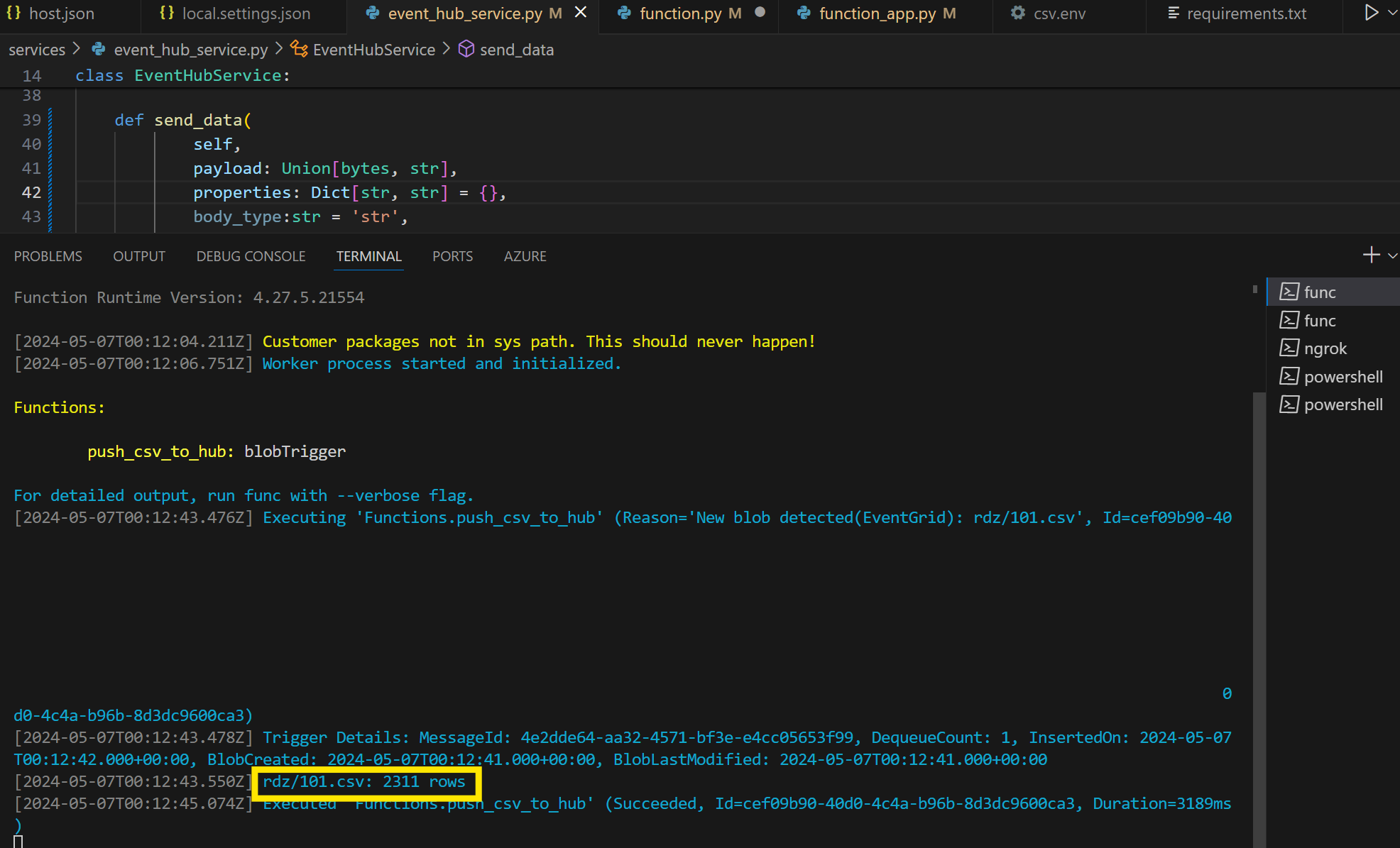

I'm using Event Hub REST API to send data to a stream. This happens in a Functions with BlobStorage trigger.I feel a little confused with some terminology which I've not found the proper documentation to finally fully understand.
I built this dashboard to get insights of my experiment. Basically, I'm sending differents data formats via Event Hub. This includes CSV, CSV compresed, JSON... and may be later Parquet and AVRO. The trigger on the BlobStorage reacts to CSV file uploads. After Event Hubs, there is another Functions that read from it and send the quantity of message to Power BI Service Push dataset API.

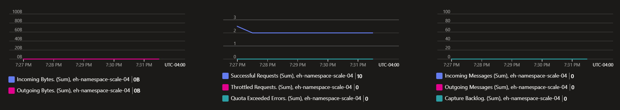

  • The metric Throttled Requests ¿ does it reject all the request? ¿or some of the events are sent properly and others not? I thinking about on single and batch events sendings
  • The metric Capture Backlog ¿What is it?

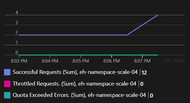

The response code is 413, and the message tells nothing about throttling. More over, the throttling metric won't show up on Azure Monitor; instead, it looks like a correct API CALL

Key note: the main objective of my experiment is to demostrate that If I send a CSV serialized (or compressed, also test it by me), I would be able to send more events per unit time. Look how I've been able to send 2.311 rows, far beyond the limit of 1000 events per publication. This is because the entire serialized CSV file is considered as one single event

    Regarding your first question about the Throttled Requests metric, this metric indicates the number of requests that were rejected due to throttling. This means that some of the events may have been sent properly, but others were rejected. Throttling can occur when the number of requests exceeds the capacity of the Event Hub. This can happen with both single and batch event sendings.
    Regarding your second question about the Capture Backlog metric, this metric indicates the number of events that are waiting to be captured by the capture feature. The capture feature allows you to capture events from an Event Hub and store them in a storage account for further processing. The backlog can occur when the capture feature is not able to keep up with the incoming events.
    Regarding the response code you are seeing when uploading a file larger than 1 MB, the 413 response code indicates that the payload of the request is too large. This can happen when the size of the file you are trying to upload exceeds the maximum size allowed by the Event Hub. The throttling metric may not show up in Azure Monitor because the request was rejected due to the payload size, not due to throttling.
