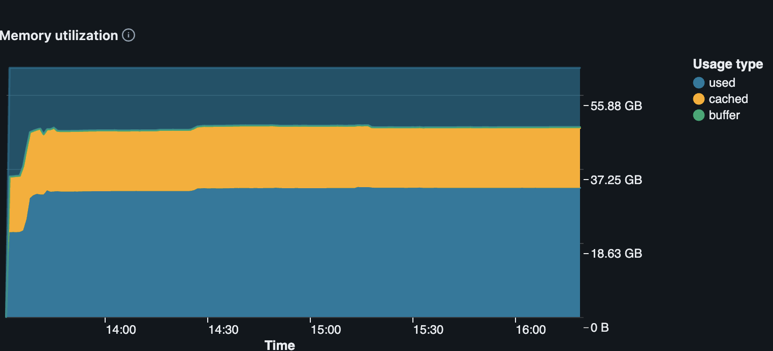

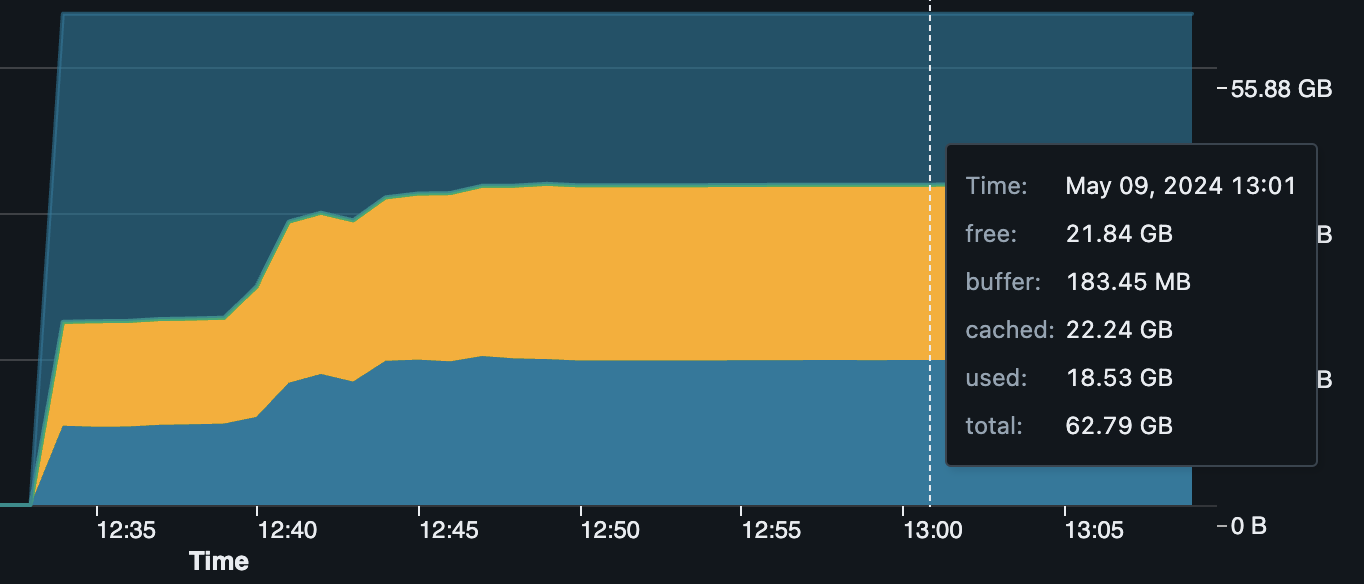

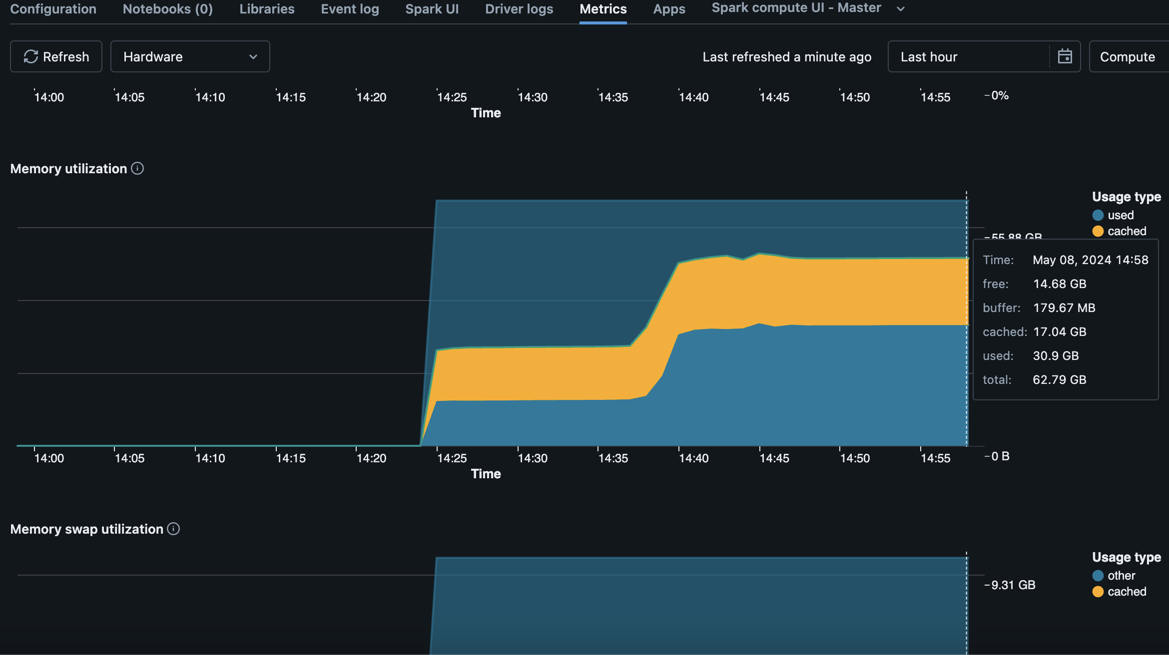

We are having unnecessary high memory usage even when nothing is running on the cluster. When the cluster first starts, it's fine, but when I run a script and it finishes executing, nothing gets back to the idle (initial) state (even hours after nothing else was executed).

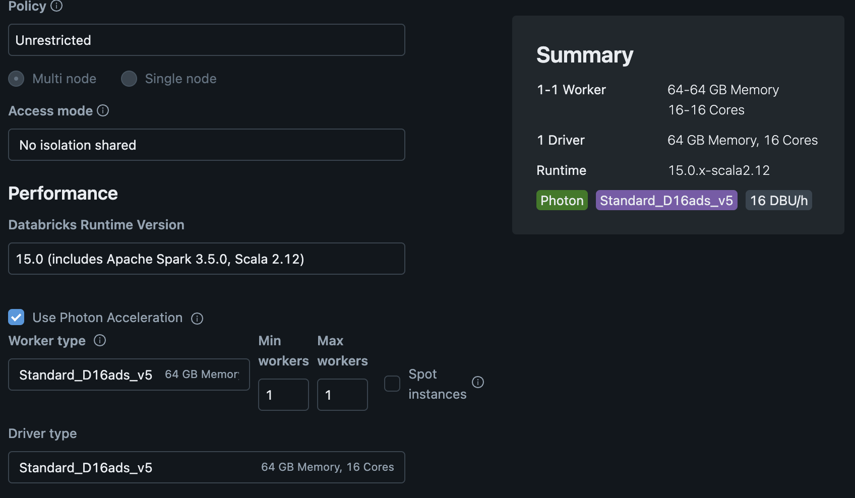

Cluster config:

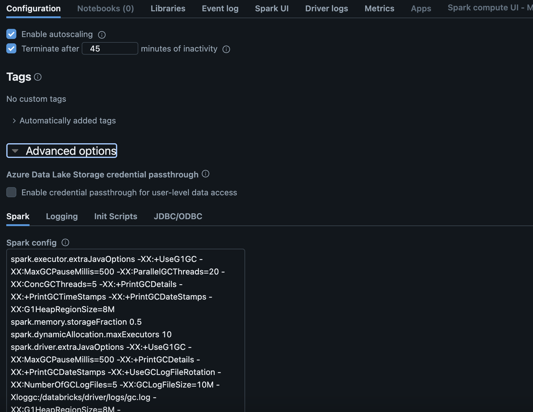

Some settings i tried:
Screenshot 2024-05-08 at 10.56.41
Spark Config:
spark.executor.extraJavaOptions -XX:+UseG1GC -XX:MaxGCPauseMillis=500 -XX:ParallelGCThreads=20 -XX:ConcGCThreads=5 -XX:+PrintGCDetails -XX:+PrintGCTimeStamps -XX:+PrintGCDateStamps -XX:G1HeapRegionSize=8M spark.memory.storageFraction 0.5 spark.dynamicAllocation.maxExecutors 10 spark.driver.extraJavaOptions -XX:+UseG1GC -XX:MaxGCPauseMillis=500 -XX:+PrintGCDetails -XX:+PrintGCDateStamps -XX:+UseGCLogFileRotation -XX:NumberOfGCLogFiles=5 -XX:GCLogFileSize=10M -Xloggc:/databricks/driver/logs/gc.log -XX:G1HeapRegionSize=8M -XX:+ExplicitGCInvokesConcurrent spark.dynamicAllocation.enabled true spark.memory.fraction 0.6 spark.dynamicAllocation.minExecutors 1

    I have a similar problem and it does not seem like the root question at hand is getting answered. Why is there so much memory in the first place? I am experiencing exact same situation with a very simple join operation on a 3x9 pyspark dataframe. As soon as I click run at all, same memory consumption as shown above is seen in mine. Where is all this memory usage coming from? My same code ran fine a week ago.

    I am experiencing the same problem. I even switched from a 28 Gb Memory cluster to a 56 Gb. It gets completely full after the first run

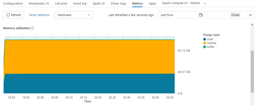

    Same problem here, I did the same as the user in the last comment, increased the cluster memory. But it still shows almost 100% memory utilization long after the script in a Notebook has completed. Ironically, clearing the cache does not help. Only way to solve it is to restart the cluster.
