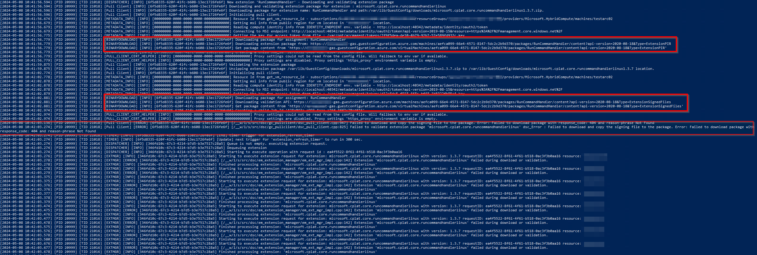

When trying to run a simple command like "echo Hello World" on an Azure Arc joined machine connected to an Azure Arc Private Link Scope, the command hangs indefinitely. Looking through the logs, we find this:2024-05-08 14_16_24-image
Has anyone seen this before?

    This is a bug i Azure. As this functionality is currently in preview, it should be fixed some time in the future.
