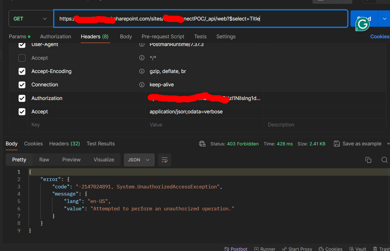

Observation and Conclusion: When using the above approach we weren't able to access SharePoint and always got the 403 error System.UnauthorizedAccessException although we were able to get the access token but when making any request with that token we were getting this error. References: How To Perform A SharePoint App-Only Authentication In Power Automate

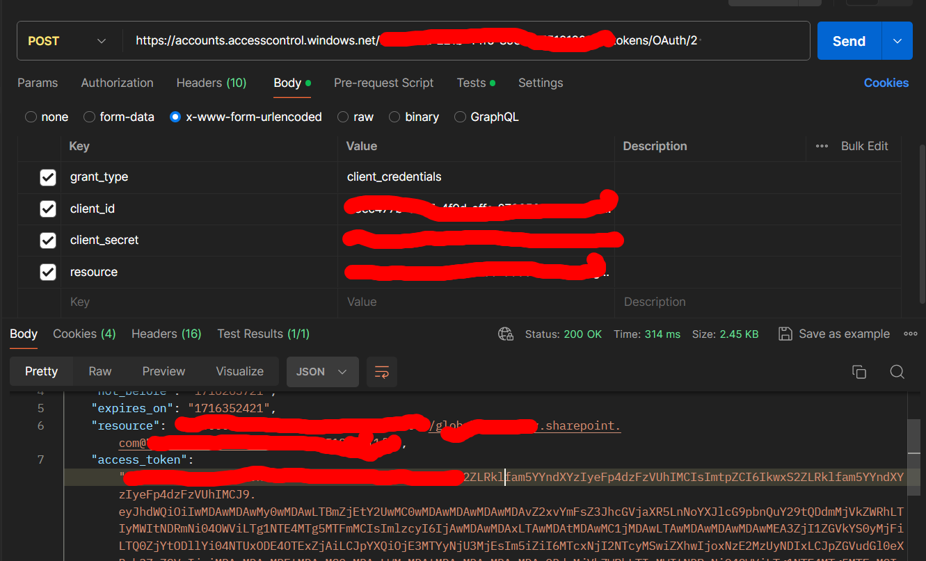

here is the Postman request for my token generation which works fine and I can generate a token
but when I use this access token I get the following error

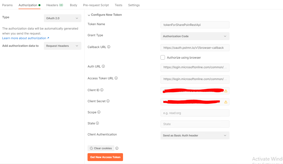

    For Azure AD App-Only for SharePoint, you could get the access token like this:
    Grant Type :         Authorization Code
    Callback Url :       this should be the AAD App redirect Url
    Auth URL :           https://login.microsoftonline.com/common/oauth2/authorize?resource=https%3A%2F%2F<tenant_name>.sharepoint.com
    Access Token URL :   https://login.microsoftonline.com/common/oauth2/token
    Client ID :          <client_ID>
    Client Secret :      <Client-secret>
    When you click Get Access Token, it would request you to sign in. After signing in, you would access it successfully.
    Reference: https://www.ludovicmedard.com/use-postman-and-azure-ad-to-send-rest-request-to-sharepoint-online/
