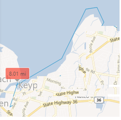

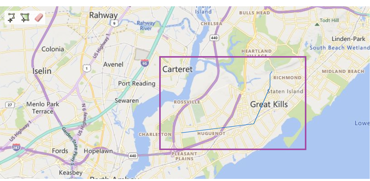

We are utilizing the Bing Maps drawing tool to create lines on the map, and we have successfully drawn the desired line. Additionally, we have a further requirement to display the distance or length of the drawn line. We are seeking a method within Bing Maps to showcase this information atop the line.
Bing map draw line:
1
Below is what we are looking for: a line with length and distance displayed.
2
