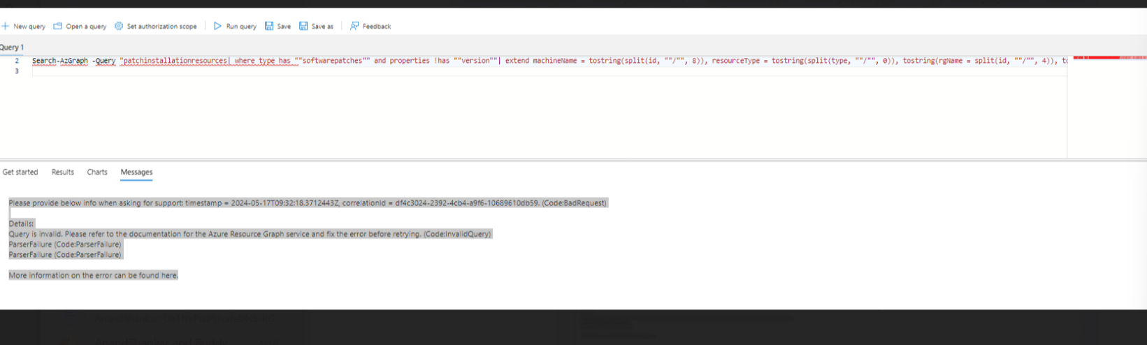

I am trying to execute following query
Search-AzGraph -Query "patchinstallationresources| where type has ""softwarepatches"" and properties !has ""version""| extend machineName = tostring(split(id, ""/"", 8)), resourceType = tostring(split(type, ""/"", 0)), tostring(rgName = split(id, ""/"", 4)), tostring(RunID = split(id, ""/"", 10))| extend prop = parse_json(properties)| extend lTime = todatetime(prop.lastModifiedDateTime), patchName = tostring(prop.patchName), kbId = tostring(prop.kbId), installationState = tostring(prop.installationState), classifications = tostring(prop.classifications)| where lTime > ago(30d)| project lTime, RunID, machineName, rgName, resourceType, patchName, kbId, classifications, installationState| sort by RunID
but coming up with following error:
Please provide below info when asking for support: timestamp = 2024-05-17T09:32:18.3712443Z, correlationId = df4c3024-2392-4cb4-a9f6-10689610db59. (Code:BadRequest) Details: Query is invalid. Please refer to the documentation for the Azure Resource Graph service and fix the error before retrying. (Code:InvalidQuery) ParserFailure (Code:ParserFailure) ParserFailure (Code:ParserFailure)

  1. tbgangav-MSFT 10,426 Reputation points Moderator
    2024-05-17T16:33:47.7533333+00:00
    Hi @Diptesh Kumar ,
    Search-AzGraph is a PowerShell cmdlet so if you want to query the resources using that PowerShell cmdlet then try it out in any appropriate PowerShell prompt. Before using it, make sure the cmdlet related module is imported.
    Or in this case you could run patchinstallationresources table related command directly in your resource graph explorer.
