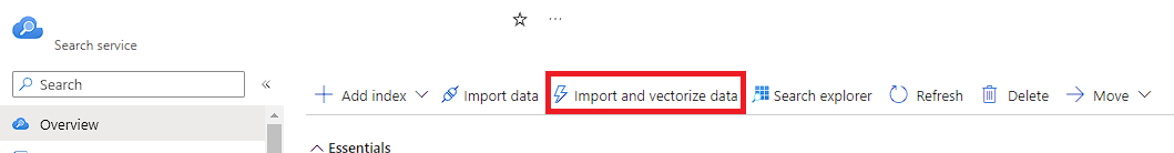

    Here is the part of the article that helped me (I added my own screenshot for copyright reasons):
    1. Azure AI Search — integrated vectorisation (IV). The newest tool in the box is the integrated vectorisation support on Azure AI Search. Triggered by the “import and vectorize data” tool, IV creates a data source, an index, skillsets for data chunking and vectorization and finally an indexer.
    The indexer can then be periodically rerun, to incrementally update the index or called out via a REST API call e.g. upon a new document being uploaded to a blob container which triggers an Azure Function calling the REST API…
    Once created indexer can recognize the delta in the defined data source (e.g. new documents in the predefined blob container folder) and only index the delta and update the index with it.
    Azure AI search skillset that chunks documents and generates embeddings. You can modify the chunking parameters such as the chunk size and chunk overlap.
