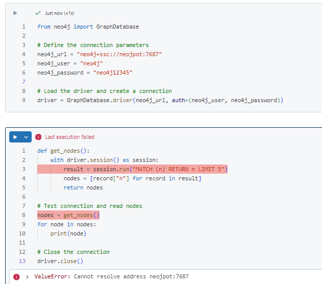

I want to connect to neo4j from Azure Databricks. What are the different approaches do I have?
I am trying to connect here and i getting following error.
Do I need to do anything before running the code? i mean setup managed identity or enable the private endpoint for neo4j? please help me here.

    To connect Azure Databricks to Neo4j, you can use the Neo4j Spark Connector. This connector allows you to read and write data from Neo4j using Spark DataFrames.
    Regarding the error message you are experiencing, it seems that the address you are trying to connect to is not resolving. Please make sure that the address and port number are correct and that the Neo4j server is running and accessible from your Databricks cluster.
