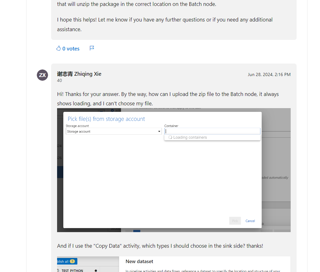

  2. When I run my Python jobs through ADF's Batch service, I get som troubles.
For example: My test.py script and the utils folder are located in the run_python folder. The test.py script calls the test1.py script in the utils folder. But when running the script using ADF, there is an issue where it cannot find the utils folder.
How I can keep the structure in Batch service's node.
