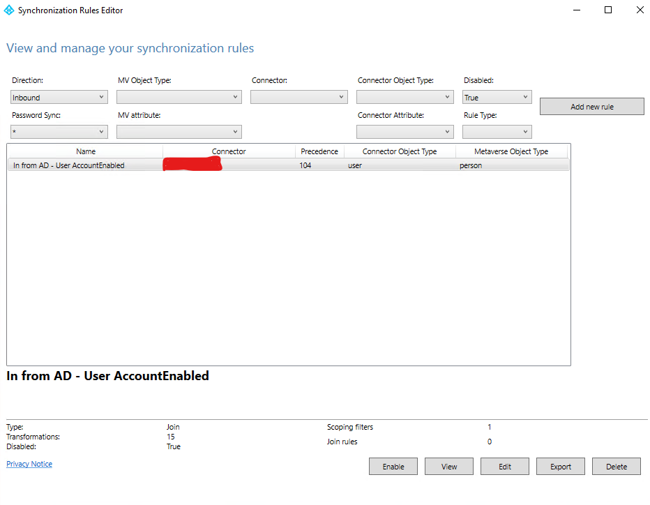

    This doesn't work and the sync was already active with the service account.User's image
    By using the "Synchronization Rules Editor" can this allow me to do synchronization just by taking into account the "ObjectGUID" attribute of an OU? Because I just want to deactivate the users. Meeting rooms, shared boxes are deactivated in the active directory but I want them to remain active in Azure AD
