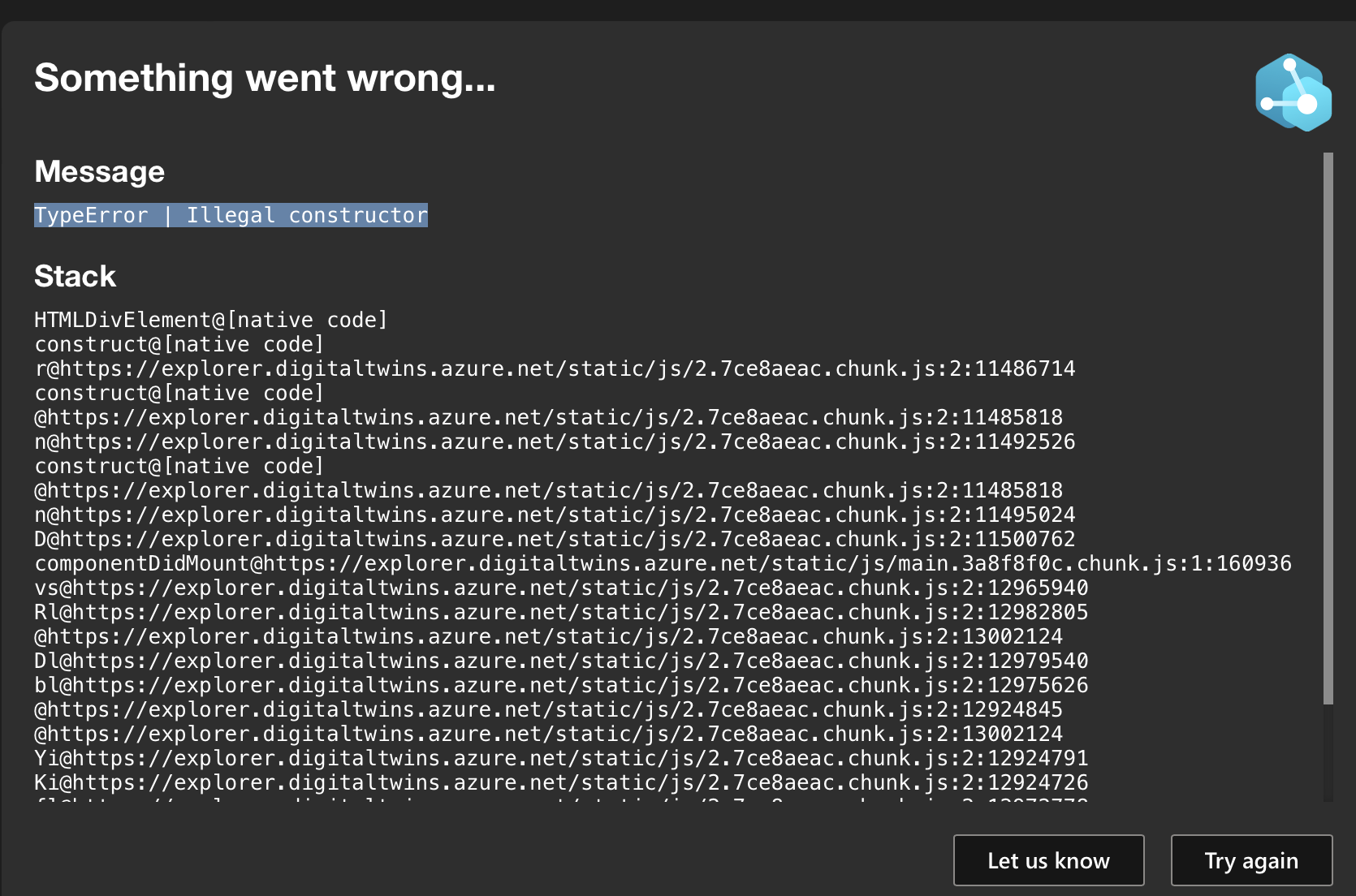

I'm new to Azure IoT - I have created Azure digital Twin, and given it permission owner,
When I open Azure Digital Twin Explorer (preview) via the portal.azure, message appears about pop up blocking, I have allowed all popups for Azure. The window appears briefly and disappear (assuming is the authentication?)
Once this window disappear, error message is thrown - User's image
What I want to do is understand the data that is reported from my Dusun gateway device as i have senors connected to this - I then want to model this data in the Azure Iot Central Hub.
Any tips?

  2. Sander van de Velde | MVP 36,776 Reputation points MVP Volunteer Moderator
    2024-06-25T20:41:23.5333333+00:00
    Hello @Abdiqani Jama,
    welcome to this moderated Azure community forum.
    You have created an Azure Digital Twins resource and you assigned Azure Digital Twins Data Owner Role. This option was available during the creation of the resource or you can set it in the Access control pane:
    Should be able to see you have access to Azure Digital Twins:
    The ADT explorer is a separate website, not bound to the Azure portal so you need to log in again with the same credentials for this ADT explorer.
    It is recommended to try this inside an InPrivate browser session.
    Make sure you log in with the same credentials.
    I just tried it myself and it works for me in the West Europe region.
