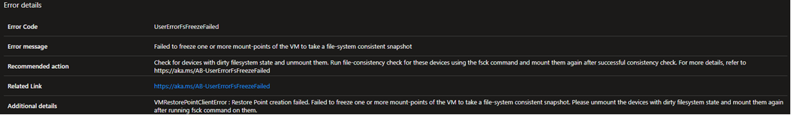

Started running into an issue with backing one of our Azure VMs.  The VM is a Linux VM running a customized Ubuntu that runs our Enterprise GitHub instance.
These backup errors seem to have begun on 6/22 and the below is the verbiage associated with the error.

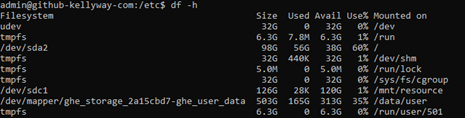

I have done the recommended action and looked for all devices with a dirty filesystem on the VM itself
But these have all come back as clean
I have also tried excluding the data disk from backups and still ran into errors so I’m unsure where the issue could be with the backups.

    Hello @Rmentor Thank you for reaching out to us and sorry for the inconvenience caused to you.
    The error message "Failed to freeze one or more mount-points of the VM to take a file-system consistent snapshot" typically indicates an issue with the snapshot process of Azure Backup for Linux VMs.

    Verify if there are any disk or file system issues on the Linux VM that could be affecting the backup process.
    Run file system checks fsck to ensure the integrity of the file systems.
    Ensure that there is enough free space on the VM's disks to accommodate the snapshot operation.
