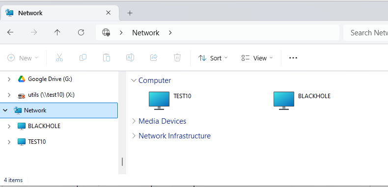

    I can see my shared machines:
    grafik

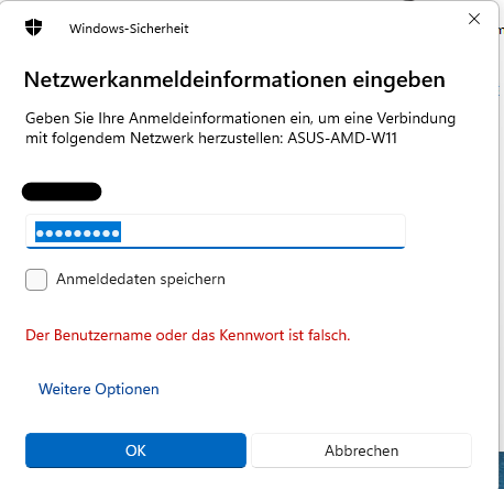

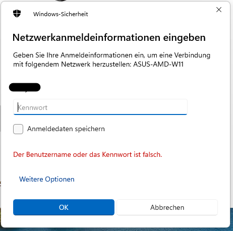

    When trying to lock-in first I get the normal lock-in mask:
    grafik
    When entering the Microsoft account credentials I am getting this answer:
    grafik
    It says that either the username or the password would be wrong.

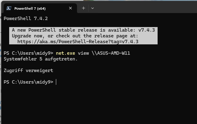

    When using the terminal I am getting another error message:
    grafik
    Here it says: Access denied
    It does not matter if I enter the name and password of the local user or of the Microsoft account.

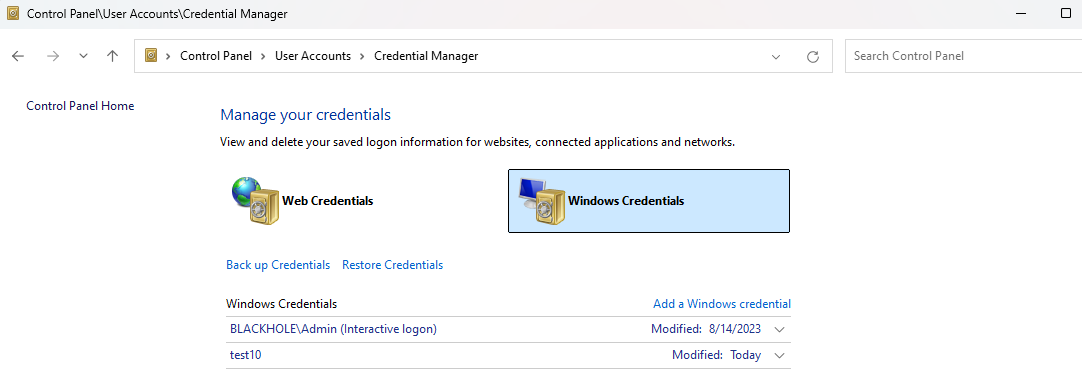

    Check the credential manager.
    I have 2 Win11 laptops which I have added my Microsoft account to and can access shared folders. I do not get prompted for credentials.
    I also have a VM named test10 that I play with. I only have a local account named admin defined on it because I periodically rebuild it. To access it I added an entry for test10\admin to the Windows credentials.
    If you don't have your MS account defined to those machines, then you can add an entry for each of your pc's (using a local account).

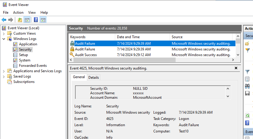

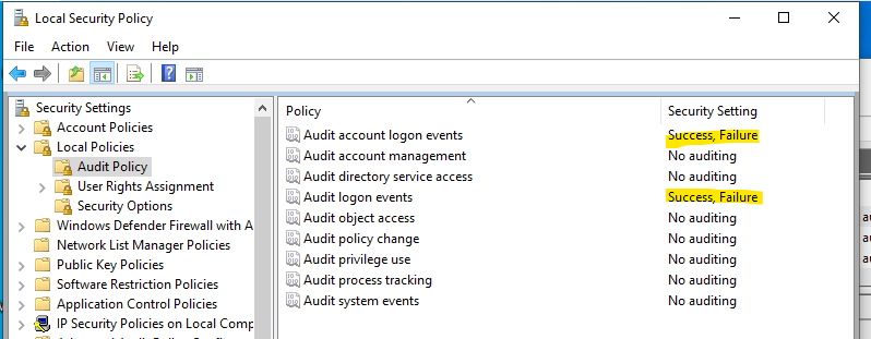

    Also check the security eventlog for logon failures.
    If you don't see any events, then you may need to enable auditing.
