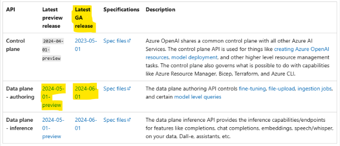

    The URL should look like below:
    https://angkulcus.openai.azure.com/openai/deployments/angkuLC4o/chat/completions?api-version=2024-06-01

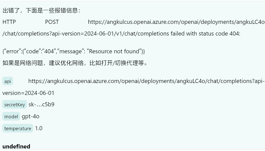

    If the plugin is adding (appending) v1/chat/completions then the URL looks like below and it will throw a 404 error:
    https://angkulcus.openai.azure.com/openai/deployments/angkuLC4o/chat/completions?api-version=2024-06-01/v1/chat/completions
    This needs to be looked by the plugin. It shouldn't append the v1/chat/completions to the URL. Please report this issue with plugin team.
