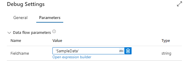

    Based on this old thread :
    I am thinking, probably the issue is not with the pipeline parameters or variables. Wondering , if you have Rule-Based Mapping in any of your DataFlow activity. In the rule-based mapping, you can define columns "name", "type", "stream", "origin", "position" etc. Would you please check the expression (if you have any), there is possibility that it could caused this error.
