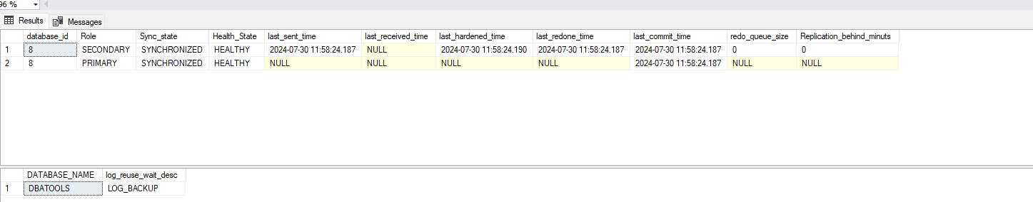

and SELECT [name] AS DATABASE_NAME , log_reuse_wait_desc
FROM sys.databases
still shows LOG_BACKUP

    In an AG there are known side effects with the log. Sometimes all the VLFs will show 2 for the status, and sometimes you can get it to clear with a CHECKPOINT command.
    But nonetheless, there are only a couple of reasons why the log grows when you think it shouldn't. When you have an AG in either sync or async mode, you can have a transaction that is large enough to fill the log and force the log to grow. In this case you will need to have more space available.

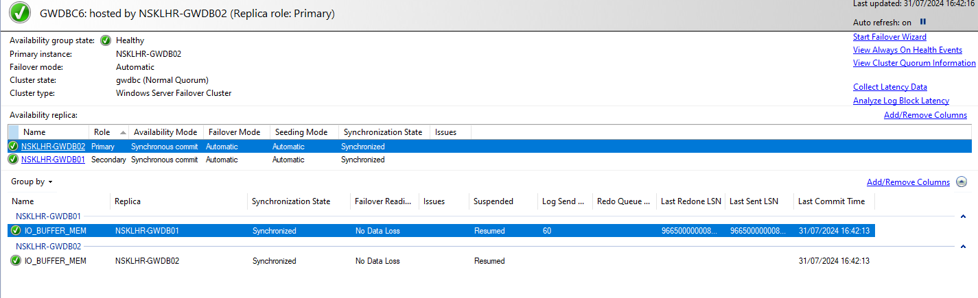

    Have you gone into the Dashboard and add columns Log Send Queue Size and Log Redo Queue Size. These queues should be small, but if they are not then it is a matter of the log not truncating because it has not been redone on the secondary side.
    It is important to understand how your AG is behaving so it is important to check the DMVs related to availability groups and it looks like one of them said that the AG is healthy. Lots of things can make the log misbehave in an AG, but knowing what to do about it is probably harder than it should be.
