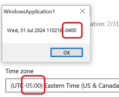

Hello all,To get the date time in this format, is there a formatter or I need to populate it part by part?
Wed, 31 Jul 2024 05:09:03 -0500
Thanks :)

    Hi @StewartBW The behavior you are observing is likely due to the distinction between Standard Time and Daylight Saving Time. Eastern Standard Time (EST) has a UTC offset of -5, while Eastern Daylight Time (EDT), which is observed during the summer months, has a UTC offset of -4.
    When you run the code during the period when Daylight Saving Time is in effect, the UTC offset will be -4, which corresponds to Eastern Daylight Time (EDT).
    You may need to manually change the offset to EST.
          Dim estZone As TimeZoneInfo = TimeZoneInfo.FindSystemTimeZoneById("Eastern Standard Time")
            Dim currentDate As DateTime = DateTime.Now
            Dim estTime As DateTime = TimeZoneInfo.ConvertTime(currentDate, TimeZoneInfo.Local, estZone)
            Dim estOffset As TimeSpan = estZone.BaseUtcOffset
            Dim formattedDate As String = estTime.ToString("ddd, dd MMM yyyy HH:mm:ss") & " " & estOffset.ToString("hh\:mm")

    Use the following
    Dim formattedDate As String = currentDate.ToString("ddd, dd MMM yyyy HH:mm:ss zzz")
    Console.WriteLine(formattedDate)
