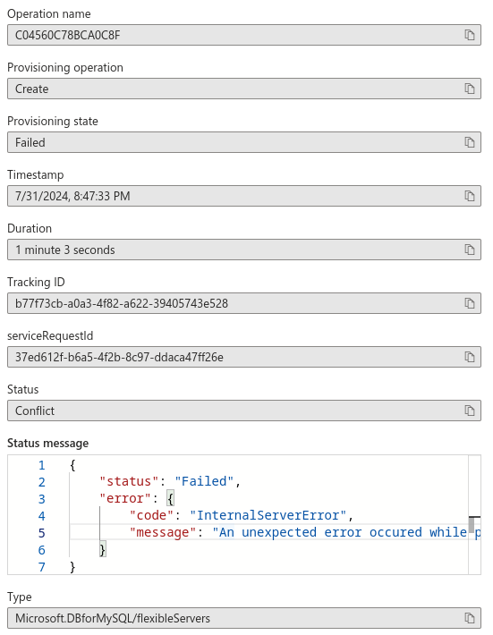

Hello,
I am experiencing an issue while attempting to restore a MySQL Flexible Server using the Azure web portal. The restoration process fails and I receive the following error message:
    "status": "Failed",
    "error": {
        "code": "InternalServerError",
        "message": "An unexpected error occured while processing the request. Tracking ID: '62114b49-1e19-40cc-8aee-9389ba9f9e88'"
backup
Screenshot from 2024-07-31 20-49-12
I've tried different restore configurations, such as change the location, the networking configuration and machine resources but the outcome was the same.
Can anyone help me figure out what I'm missing?

  1. RahulRandive 10,486 Reputation points Volunteer Moderator
    2024-08-13T20:36:47.51+00:00
    Hi @Douglas Delefrati ,
    Thanks for sharing the tracking id. Based on traking id, I have checked the backend log to find the root cause of the failure and here is the error
    Provisioning in requested region is not supported
    The error is likely due to a capacity issue with creating or restoring the server in that region. Once the quota is made available to your subscription, the restore operation should proceed successfully. Please try again
    Thank You!
