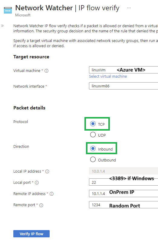

    To address your query, "If we configured site to site vpn no need to use Virtual Machine public ip for accessing the virtual machine right ?? , Instead of that we can Virtual Machine private ip right?"
    • Yes
    • This is correct
    Since you mentioned you are able to ping and access OnPrem servers, this is not a Routing issue.
    • Can you please check with your OnPrem Networking team if there are any firewalls blocking the outbound connectivity towards the S2S?
    • From Azure side, make sure no NSG is blocking inbound access to your VM
    • You can test this using NSG Diagnostics or IP Flow verify
      • User's image
      • And share the results
