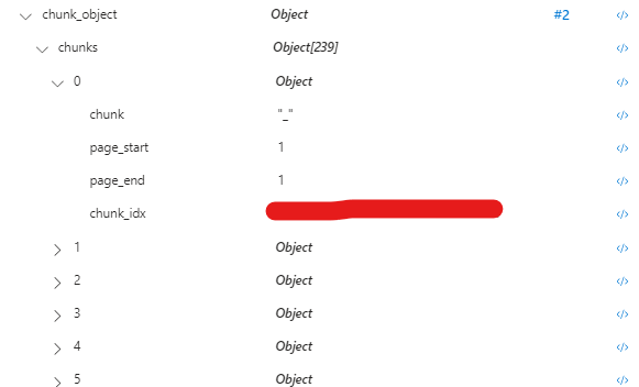

None of my approaches above are working and the index field remains unpopulated. Can anyone please suggest any pointers or the right approach here? TIA

  1. Konstantinos Passadis 19,586 Reputation points MVP
    2024-08-04T15:10:04.57+00:00
    Hello @Das Gupta, Abhijeet
    The ShaperSkill must correctly shape the output to match the structure expected by the index. From your description, it appears that the main issue lies in how the ShaperSkill is structuring the output
    You need to structure the ShaperSkill so that it correctly maps the fields from jsonChunks to the chunk_object array. Here's how you can define it:{
    "@odata.type": "#Microsoft.Skills.Util.ShaperSkill",
    "name": "#2",
    "description": "Shapes the output into chunk_object format",
    "context": "/document",
    "inputs": [
            "name": "chunks",
            "source": "/document/jsonChunks/*"
    "outputs": [
            "name": "chunk_object",
            "targetName": "chunk_object"
    Expected In-Memory Output
    The in-memory enriched data structure after applying this ShaperSkill should look like this:
    /document/chunk_object Array[239]
    -/chunk_content
    -/page_start
    -/page_end
    -/chunk_idx
    Important Notes :
    1. Ensure that the output of your custom skill (jsonChunks) has all the necessary fields (chunk, page_start, page_end, chunk_idx) correctly populated.
    2. If the custom skill's output JSON is nested differently, you may need to adjust the source paths in the ShaperSkill accordingly.
    3. The Edm.ComplexType field in the index must be defined to match the exact structure and field names produced by the ShaperSkill.
    Kindly let us know how it went !
    I hope this helps!
    The answer or portions of it may have been assisted by AI Source: ChatGPT Subscription
    Kindly mark the answer as Accepted and Upvote in case it helped!
    Regards

  3. Konstantinos Passadis 19,586 Reputation points MVP
    2024-08-05T17:09:03.04+00:00
    Yes i am sorry
    Approach 1 . This configuration assumes that all chunk_content, page_start, page_end, and chunk_idx values from the jsonChunks array should be aggregated into a single object. If multiple jsonChunks should be aggregated, additional logic will be required.
    "name": "ShaperSkill",
    "description": "Shapes the output into a single chunk_object",
    "inputs": [
    "name": "chunk_content",
    "source": "/document/jsonChunks/*/chunk"
    "name": "page_start",
    "source": "/document/jsonChunks/*/page_start"
    "name": "page_end",
    "source": "/document/jsonChunks/*/page_end"
    "name": "chunk_idx",
    "source": "/document/jsonChunks/*/chunk_idx"
    "outputs": [
    **Approach 2. Example (**If your chunk_object field is meant to hold multiple chunks (i.e., an array):
