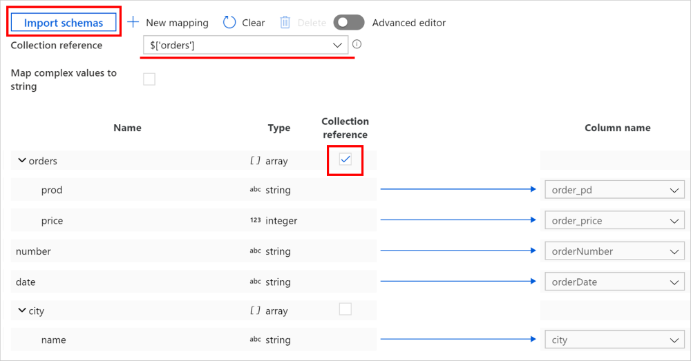

    When you edit the Copy Task you will see a Mappings menu
    Fro there you Map which columns goes to which column and you can also update he schema
    https://learn.microsoft.com/en-us/azure/data-factory/copy-activity-schema-and-type-mapping
    map-hierarchical-to-tabular-ui
    Find the selection and make the correct mappings ! It will work !
    I hope this helps!

    If you Import Schemas , the Mapping will be done automatically
    You need to have the Tables ready on the Destination though
