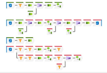

Hi, I am trying to do some no-equity left joins to join 3 tables into one in a dataflow, where every tables contains over 20 million rows of data and one of the tables contains 400 millions rows of data, and i get the errors as following when executing the data flow.User's image
The second flow is the main flow to join the other sources using no-equity left join method to the second imported source.

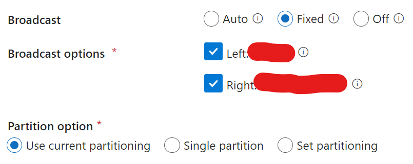

here is the joining method I am using.
I selected both option for the broadcast settings, even the execution is failed with same error indicated by selecting the 'Right' as the option for the settings
