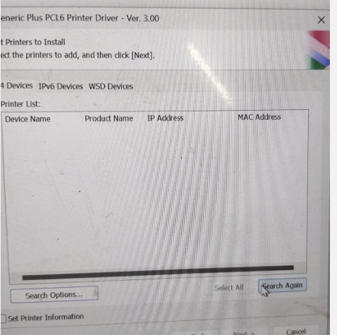

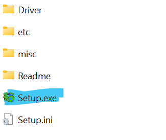

1- Canon ImageRunner Advance.exe - When we click on this EXE, a folder named 'Canon' gets created, and two folders, x86 and x64, are generated. I need to deploy the x64 version. Please suggest a PS1 script that I can use to install it silently. also during installation need languange -english
Under X64 folder
I need to package the x64 version with PowerShell for installation

    To run the Canon setup.exe silently, you have to make sure it is supported to be installed through command line. Run setup.exe /? to see if there are any install parameters.
