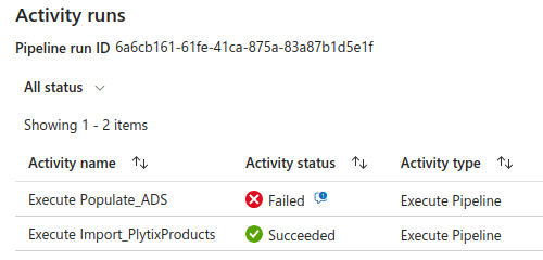

In datafactory we have a step which connects with Azure CosmosDB for PostgreSQL to copy the some data to other DB using self hosted integration runtime, Its was working fine till last week. Suddenly there is intermittent connectivity issue & we are getting following error.
The same activity able to make connection if we retry couple of times. Some stages establish connections successfully, while others fail with error.
message: Copy failed with error: 'Type=System.Security.Authentication.AuthenticationException,Message=A call to SSPI failed, see inner exception.,Source=System,StackTrace=   at System.Net.Security.SslState.StartSendAuthResetSignal(ProtocolToken message, AsyncProtocolRequest asyncRequest, Exception exception)
   at System.Net.Security.SslState.CheckCompletionBeforeNextReceive(ProtocolToken message, AsyncProtocolRequest asyncRequest)
   at System.Net.Security.SslState.ProcessReceivedBlob(Byte[] buffer, Int32 count, AsyncProtocolRequest asyncRequest)
   at System.Net.Security.SslState.StartReceiveBlob(Byte[] buffer, AsyncProtocolRequest asyncRequest)
   at System.Net.Security.SslState.ForceAuthentication(Boolean receiveFirst, Byte[] buffer, AsyncProtocolRequest asyncRequest, Boolean renegotiation)
   at System.Net.Security.SslState.ProcessAuthentication(LazyAsyncResult lazyResult)
   at Npgsql.NpgsqlConnector.<RawOpen>d__153.MoveNext()
We have also tried setting up new IR'S, for the same. But it still produces the same error output. We are unable to determine a solution to this problem, we would greatly appreciate any assistance in resolving this issue.
