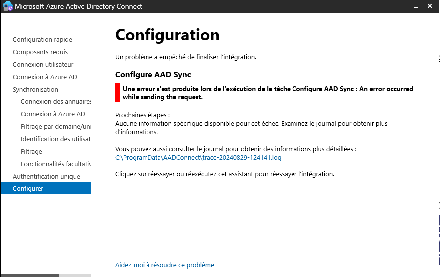

Hello,
I 'am working on a Ws server 2022, and i tried to insall Entra ID Connect, when i got an AAD Sync error.
Have you already had this ?

    Usually, that error message returns because TLS 1.2 was not enabled on the Entra ID Connect server.
    Please, run this script from the link to check the TLS status - https://learn.microsoft.com/en-us/entra/identity/hybrid/connect/reference-connect-tls-enforcement#powershell-script-to-check-tls-12

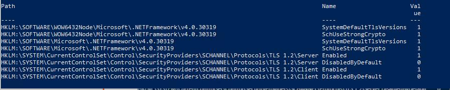

    The results must be exactly like below:
    Use this other script to enabled TLS 1.2, restart the server and then try it again
    https://learn.microsoft.com/en-us/entra/identity/hybrid/connect/reference-connect-tls-enforcement#powershell-script-to-enable-tls-12

  1. Thierry Kadji 40 Reputation points
    2024-08-29T11:56:29.19+00:00
    error sync
