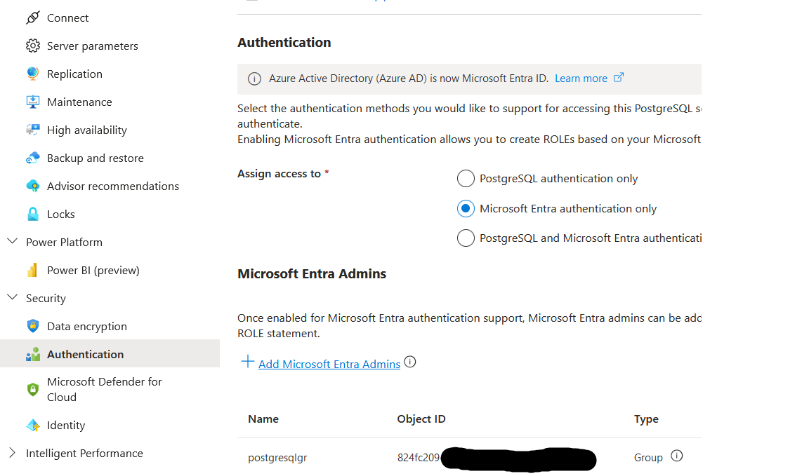

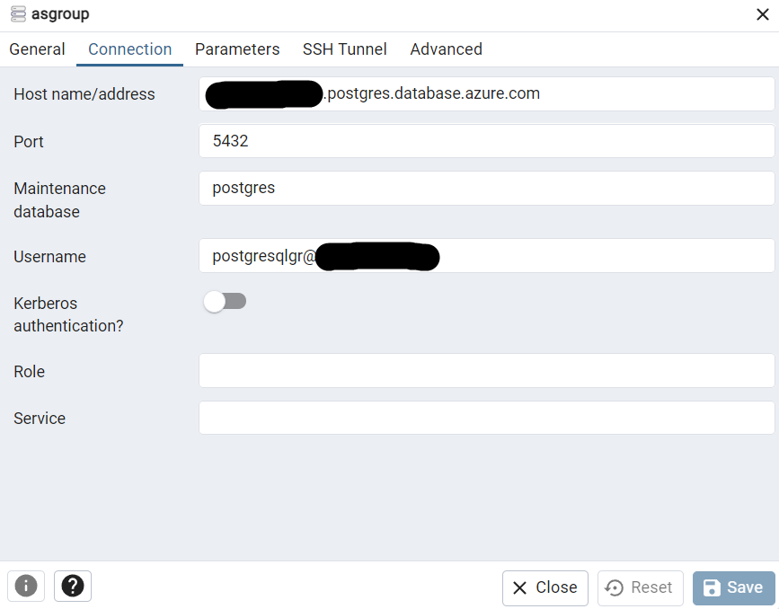

I want to connect to Azure Postgresql Flexible server using PgAdmin4 and using Entra ID group. I followed the steps from:
https://learn.microsoft.com/en-us/azure/postgresql/flexible-server/how-to-configure-sign-in-azure-ad-authentication
entragroup
My Entra ID user account is owner of this Entra ID group.
pggroup

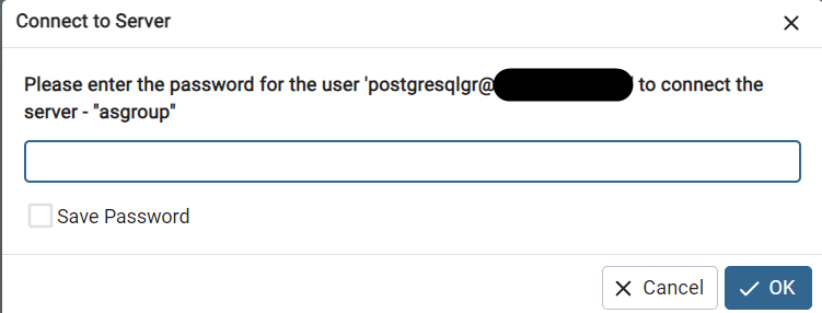

I'm using my token when prompted for password got by command
az account get-access-token --resource https://ossrdbms-aad.database.windows.net
token

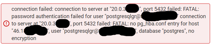

at the end i got error:
error
Maybe someone is using entra id group login and can help with that?
I can login using my personal entra id with success but not as member of entra id group.

    As I understand, you are getting error in Microsoft Entra ID for authentication with Azure Database for PostgreSQL fatal no pg_hba.conf entry for host.
    Is this the first time you are trying to connect or earlier it worked, and it is failing now?
    If first time, then please try restarting the server as mentioned here:
    https://learn.microsoft.com/en-us/azure/postgresql/single-server/how-to-restart-server-portal
    Try in the Azure Portal change require_secure_transport from server parameters to OFF.
    Let us know if this helped.
