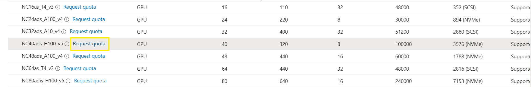

It says the plan selected does not match the number of GPUs on my VM and to select a VM with 1 GPU. But based on the title of the image, it only has one GPU... Is there a quota increase request I can fill out to satisfy this requirement? I looked through the quotas available but I couldn't find anything when I searched for GPUs...

    In this case you need to select a VM with 1 GPU to match the NVIDIA AI Enterprise is NCads_H100_v5 sizes series.
    The NCads H100 v5 series virtual machines (VMs) are a new addition to the Azure GPU family. You can use this series for real-world Azure Applied AI training and batch inference workloads. The NCads H100 v5 series virtual machines are powered by NVIDIA H100 NVL GPU and 4th-generation AMD EPYC™ Genoa processors. The VMs feature up to 2 NVIDIA H100 NVL GPUs with 94GB memory each, up to 96 non-multithreaded AMD EPYC Genoa processor cores and 640 GiB of system memory. These VMs are ideal for real-world Applied AI workloads.
    For more detailed information please refer to this: https://learn.microsoft.com/en-us/azure/virtual-machines/sizes/gpu-accelerated/ncadsh100v5-series?tabs=sizeaccelerators
    User's image To run a virtual machine with NVIDIA AI Enterprise, you need to request a quota for the specific GPU model you want to use in each region, as well as a global quota.
