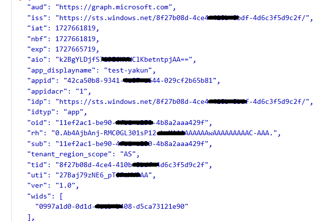

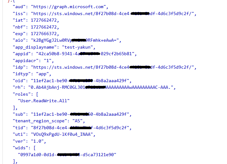

When I decode the token in the JWT decoder here:
JWT Debugger azurewebsites.net
JWT Debugger
JWT Debugger
JWT Debugger
azurewebsites.net
azurewebsites.net
JWT DebuggerJWT DebuggerJWT Debugger JWT DebuggerJWT Debugger JWT Debugger JWT Debugger azurewebsites.net azurewebsites.net

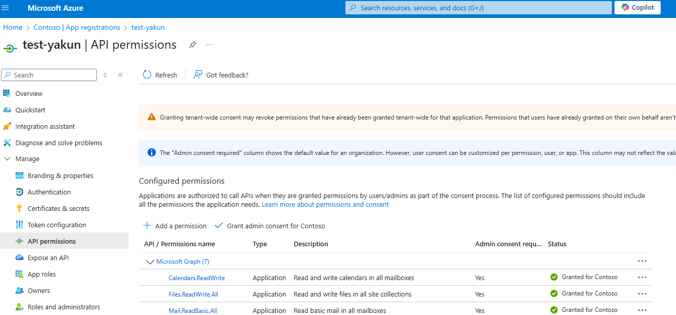

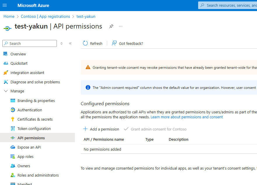

    Hi @Oskar Berntorp (Novotek Sweden)
    For this error, which is caused by insufficient permissions, you need to grant the appropriate application permissions to the application in Azure AD. You can do this in Azure, as shown below:
    The exact permissions depend on the endpoint you need to access.
    See this document for more information about client credentials flows.
    Hope this helps.

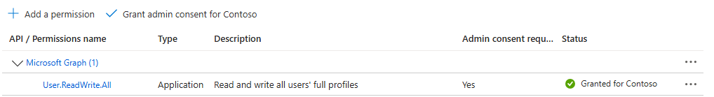

  2. Oskar Berntorp (Novotek Sweden) 10 Reputation points
    2024-09-25T11:32:35.0466667+00:00
    Hi @Anonymous ,
    I have tested to set different permissions as well as that I have admin consent, but the roles claim is still missing. So from my perspective, the permissions seems right, but I have no roles claim. When this error is shown, what are the permissions needed, is there a link that specifies them? I have followed these bellow steps: 1. Create a print job and store the resulting document ID.1. Create an uploadSession for the document.
    1. Upload bytes to the created upload session.
    2. Start the print job.
