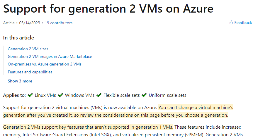

    Yes, as per the documentation: https://learn.microsoft.com/en-us/azure/virtual-machines/trusted-launch-existing-vm?tabs=portal the supported version is v2.
    I am afraid to say that you can't upgrade from V1 to V2 as per the Microsoft documentation.
    Reference: https://learn.microsoft.com/en-us/azure/virtual-machines/generation-2
    Only option is You have to create another Virtual machine with V2 and Please make a complete backup of your existing V1 VM and Restore the backup data after creating a new VM.
    But there is a recent update related to trusted launch, you can check this and see if this works out in your case.
    For Additional reference: https://azure.microsoft.com/en-us/updates/private-preview-upgrade-existing-azure-gen1-vms-to-gen2trusted-launch/
