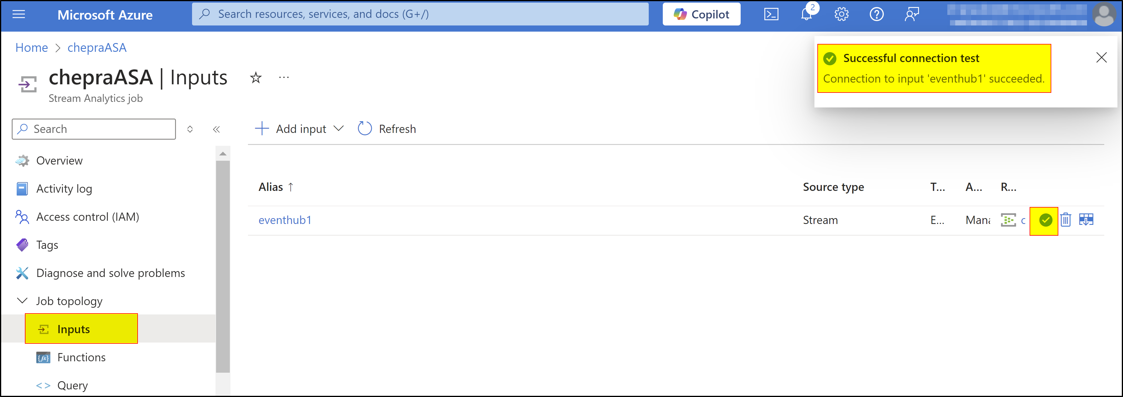

    By following the steps mentioned in the official document: Use managed identities to access Event Hubs  from an Azure Stream Analytics job, were able to successfully able to connect as shown below:
    User's image Hope this helps. Do let us know if you have any further queries.
