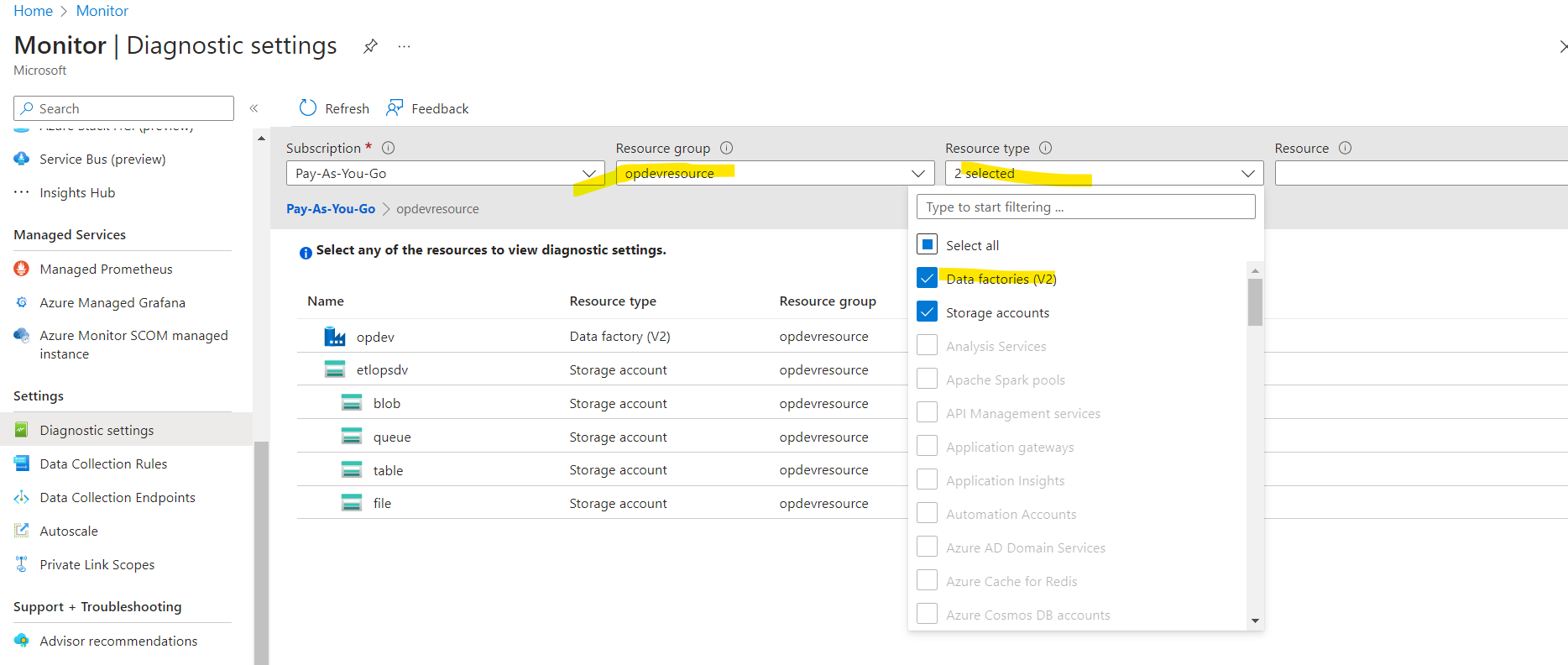

Hi experts, I have the store procedure below. Do I need to put it at the end of every activity? It won't be easy having this way.
Can I use it once to get information about all pipeline logging?
https://learn.microsoft.com/en-us/answers/questions/1922633/how-to-capture-the-each-activity-logs-in-the-table
Please help with a list of steps to follow. Thank you

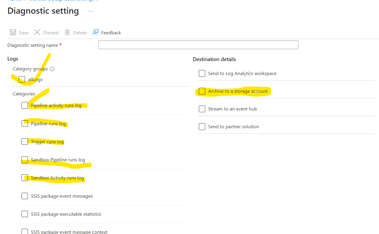

    I understand that you are trying to store all the activity logs after it's completion and using stored procedure for doing the same. But you want to know if there is any feasible way of achieving this without adding it after each and every activity.
    If your requirement is to capture the error logs, you can add the stored procedure at the end of the pipeline with the 'On Skip' conditional path.
    However, if you want to log even the success then Instead of using Stored procedure after every activity which looks tedious process, you can consider using Azure monitor Log diagnostic for doing the same as mentioned in the above thread which you shared :
    All the info will be logged in your storage account in form of Json format under today's date file in the format: yyyy-->Mm-->dd-->hh-->mm-->ss
