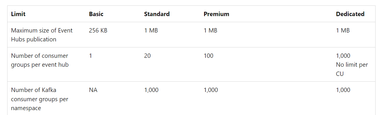

    Depending on the Event Hub tier, 1, 20, 100, 1000 consumer groups are supported (I have no experience with what 'No limit per CU' means).
    Notice that The Kafka endpoint of an Event Hub also knows the concept of consumer groups (per namespace) and the number is always 1000. Please check the documentation of this endpoint and what a consumer groups means there.
