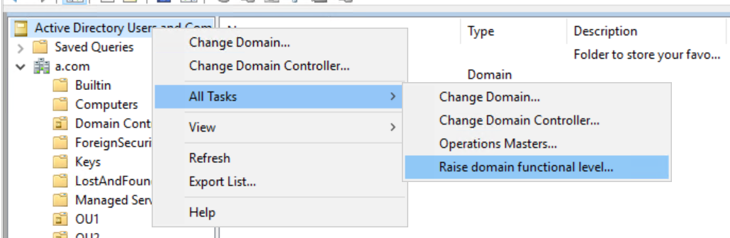

    The domain function level can only be upgraded on the PDC simulation simulator operation host;

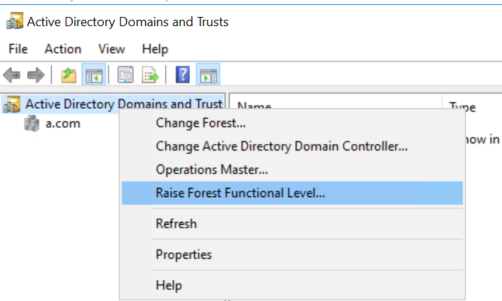

    Forest functional levels can only be upgraded on schema operations hosts.
    Open AD domain and trusts to raise forest functional level.User's image
    Open AD Users and Computers to raise domain functional level.User's image
