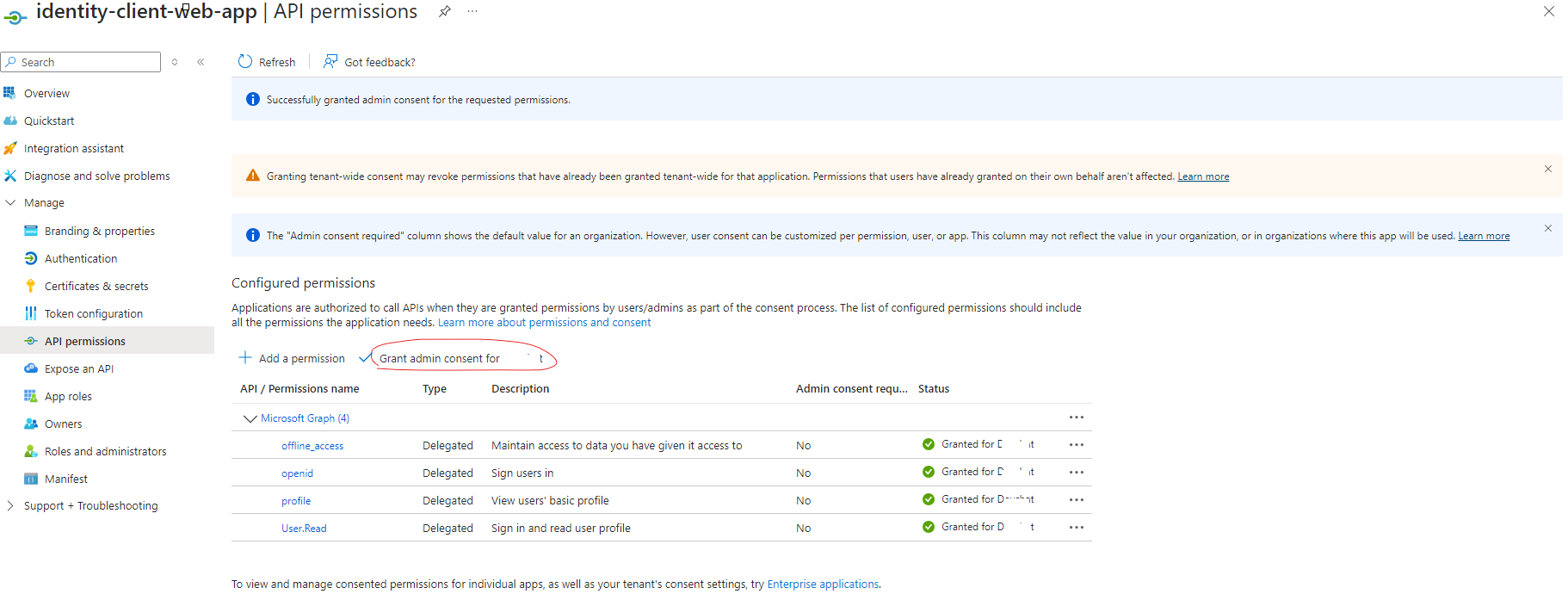

    2024-11-06T06:21:02.0766667+00:00
    Hi @Ron Raney,
    Thanks for your patience, I have test it in my local and reproduce the same issue.
    After checking the error message in output window, we found the issue is related to permission. Here is my error message.
    The user or administrator has not consented to use the application with ID '63f****-7**2-4**d-a**0-60*****8dbbc' named 'identity-client-web-app'. Send an interactive authorization request for this user and resource.
    Then I grant admin consent like below, and it starts to work. If you don't have the admin permission, you can contact your administrator help you.
