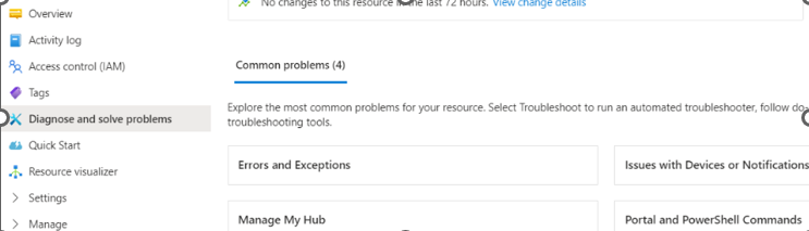

    If you haven't done, (when the issue reoccurs) you may leverage Notification Hub diagnostics > from Azure Portal> Navigate to your Notification Hub app in the Azure Portal.
    In the left navigation, click on Diagnose and solve problems - Review - “ diagnostics options' to fetch additional info: ( screenshot below)

    We also checked the diagnostics panel, but it provided no further insights.
