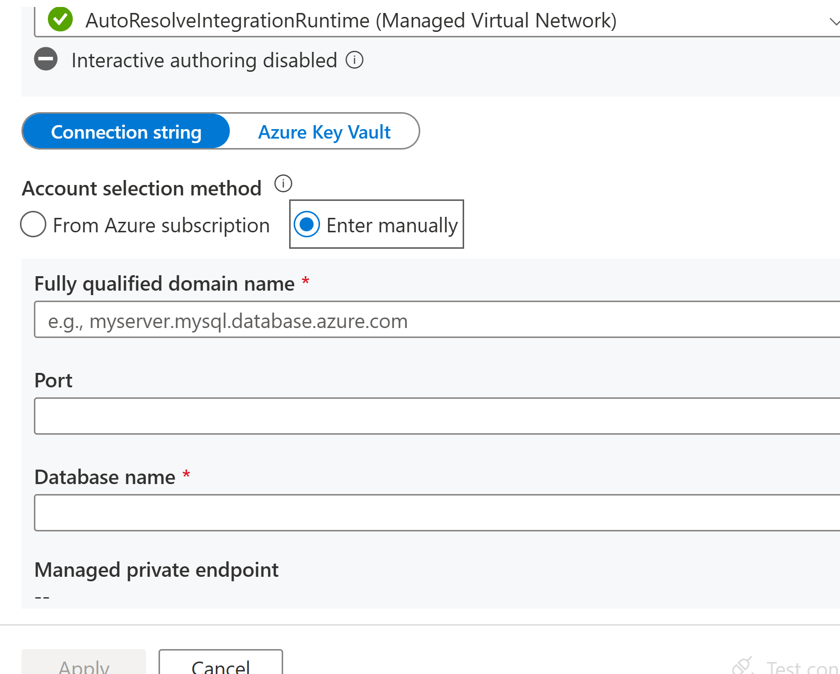

    2024-11-08T12:17:15.1266667+00:00
    Hi @Pinaki Ghatak ,
    thanks for your answer. The syntax you provided with me was working from the "syntax" perspective and also after running my CD pipeline I was able to see correct connection strings values per einvironemnt in my repos - dev string for dev environment, test for test env etc...The issue is within the synapse it did not fill that string to linked service setup -see picture.
