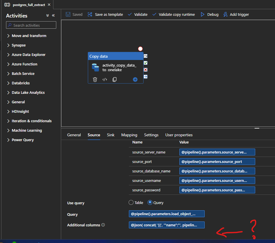

I'm using Azure Data Factory copy data activity to move data from Azure PostgreSQL to OneLake. I'm using a self-hosted integration runtime for that (because of how our VNETs are set up).
Here is the error I'm getting:
Operation on target activity_copy_data_to_onelake failed: 'Type=Npgsql.NpgsqlException,Message=Exception while reading from stream,Source=Npgsql,''Type=System.NotSupportedException,Message=The Read method cannot be called when another read operation is pending.,Source=System,'
The same setup works perfectly for all the other tables in the same database, but fails for one. It might be because the problematic table is bigger than others (50 columns x 6M rows).
Here's what I have tried with no success in solving the problem:
  • Setting connection timeout to 600 and command timeout to 0 (no timeout) in the linked service connection string.
  • Setting pooling to "no" in the linked service connection string.
  • Running the same query by pgAdmin. It succeeded, but took 18 minutes. In ADF it fails after ~200 seconds. The query itself is a simple SELECT * FROM <table>
Does anyone have any ideas how to diagnose or solve this problem?
